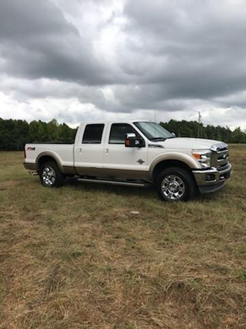

I'll say this. We just this week bought a 2014 F250 Lariat fx4 6.7. If you don't want to buy a newer truck.. DO NOT go and drive one lol. The Foo Foo meter is peaked out. We haven't towed with it yet but we have a trip coming up in two weeks. Can hardly wait.
