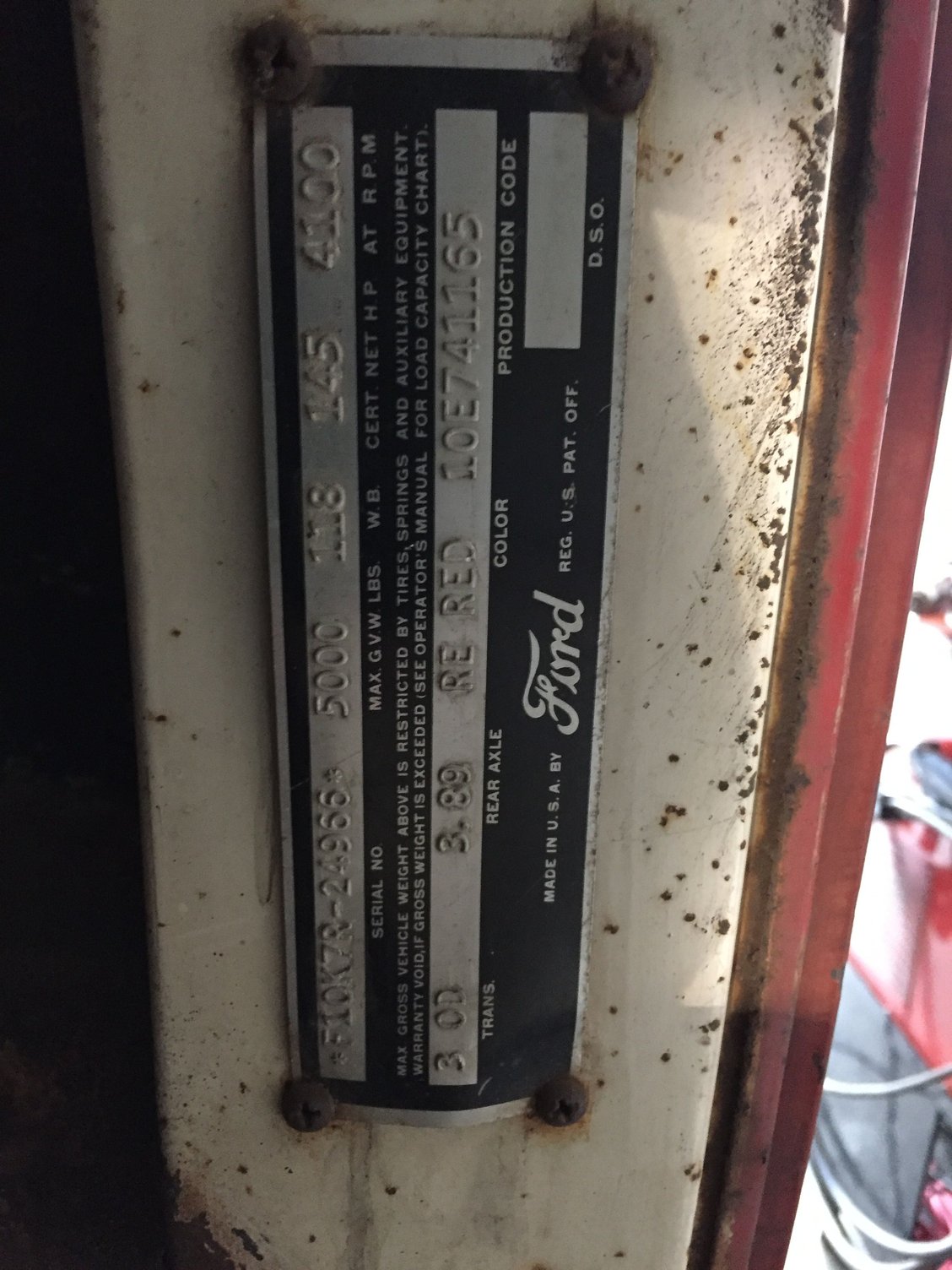

Vin tag decoding please
Can someone please decode my vin plate please 🙃
can someone please explain some of my vin plate. Thank you!
color- RE RED (I’m pretty sure it’s original red/white two tone so the “RE RED” confuses me)
rear axel- 3.89 (8”or 9”)?
and I’m assuming the vin plates changed style sometime in 1957?
And whatever the production code means
Thanks again!

F10 = F100 2WD
K = 272 2V
7 = 1957.
R = San Jose CA Assembly Plant.
24966 = 1957 Numerical Sequence of Assembly, the trucks specific serial number.
5,000 lbs. Gross Vehicle Weight Rating.
118" Wheelbase.
145 net HP @ 4,100 RPM
Borg Warner T-86 3 speed M/T with Overdrive.
Ford 9" Rear Axle / 3.89-1 / 3,300 lbs. Rear Axle Capacity.
RE RED R is Red and E is Colonial White. What RED refers to, I dunno.
10E741165:
10E = Assembled May (E) 10, 1957. 741165 cannot be decoded.
8" introduced in 1962 for mid-sized Passenger Cars, initially Fairlane/Meteor 221/260 V8.
