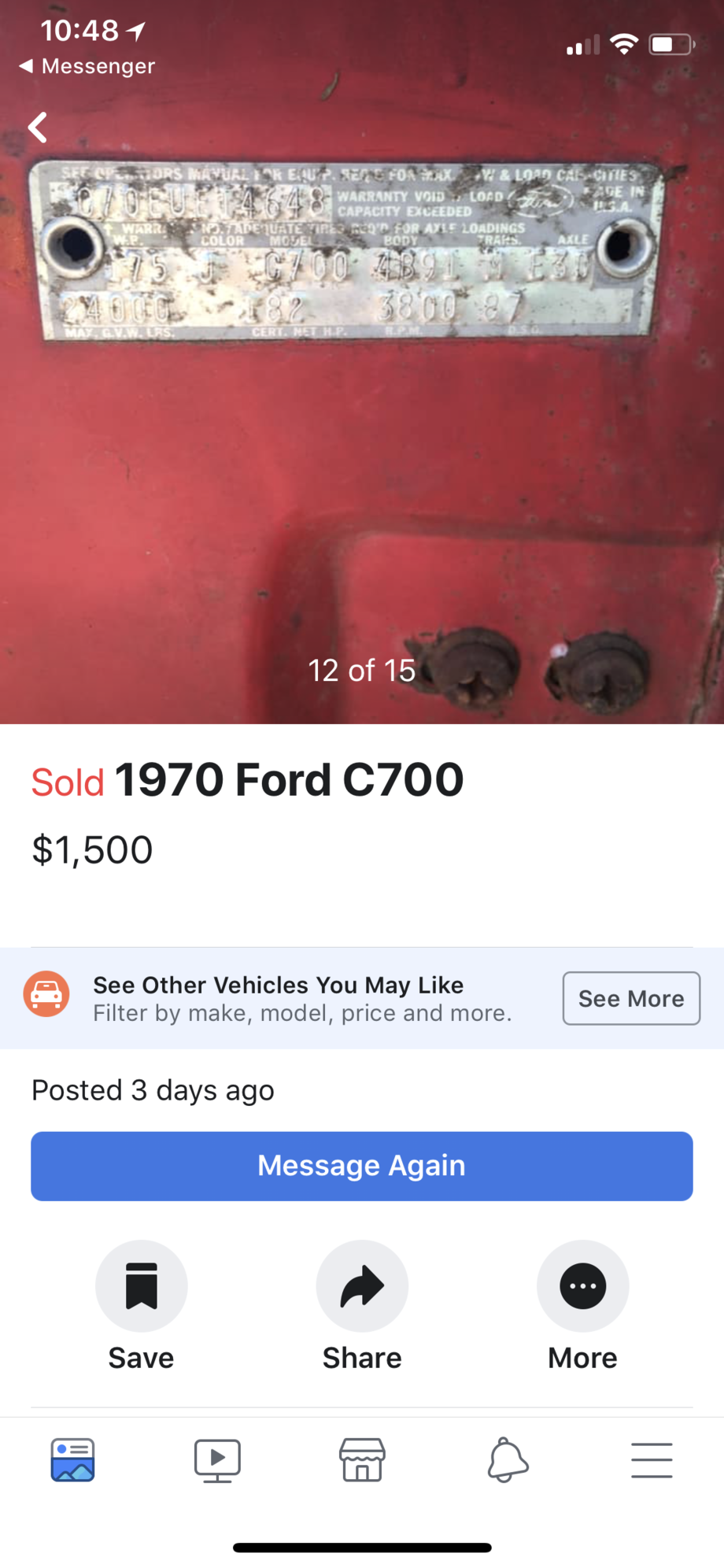

C700 vin decode
Can someone help decode vin please. Just bought truck
Old Feb 24, 2019 | 12:00 AM
NumberDummy's Avatar
NumberDummy
Ford Parts Specialist
Posts: 88,826
Likes: 787
From: Simi Valley, CA
Originally Posted by 4BDiesel
Can someone help decode VIN please.
Welcome to FTE
This Warranty Plate is so filthy, it's very hard for my 74 year old eyes to read. However, I was able to expand the pic, so the following should be correct.
C70 = C700 Tilt Cab (gas).
E = 361 2V FT engine.
U = Louisville KY Assembly Plant.
E14658 = 1969 (1969 serial number range: D82,001-G30,000).
175" Wheelbase.
J = Rangoon Red.
C700 Tilt Cab (gas), 24,000 lbs. GVWR
4B91: 4B = Black all Vinyl // 91 = 91A Standard Cab.
M = Clark model 250VO 5 Speed Direct (this appears to be an M, but I'm not sure).
F3C:
F3 = Eaton model 15201 Two Speed Rear Axle / 6.33/8.81 / 15,000 lbs. Rear Axle Capacity.
C = Ford-Rockwell/Timken 6,000 lbs. Capacity Front Axle (this appears to be a C, but I'm not sure).
24,000 lbs. Gross Vehicle Weight Rating.
182 net HP @ 3,800 RPM
87 = Sold to a body company.

OP should recheck the axle code. 24000 gvwr with 21000 axle capacity?

Vin
here is what I’m ready off it.
C70eue14648
was told it is a 1970 don’t know if that is correct.?

Middle line. Trans and axle codes.
Post 2 says it's a 1969. The trans and axle codes aren't clear.
Where did you see 21,000 lbs? It's 15,000 lbs.
As noted in the decode, the TRANS code and 3rd digit of the AXLE code are very difficult to make out.
E14658 = It's a 1969! I told the OP this and listed the 1969 serial number range D82001-G30000 to prove it.
I've decoded 100's of these Warranty Plates, but it would be nice if people would clean them off before taking pics.

15000 rear and 6000 front. Don't add up to 24000.
No, but that gives you 3,000 lbs. to play with.
The 3rd digit of the AXLE code appears to be a C but the plate is so filthy, one would have to look at the Warranty Plate in person to verify.
If it was me, I'd rub some steel wool on it first.
