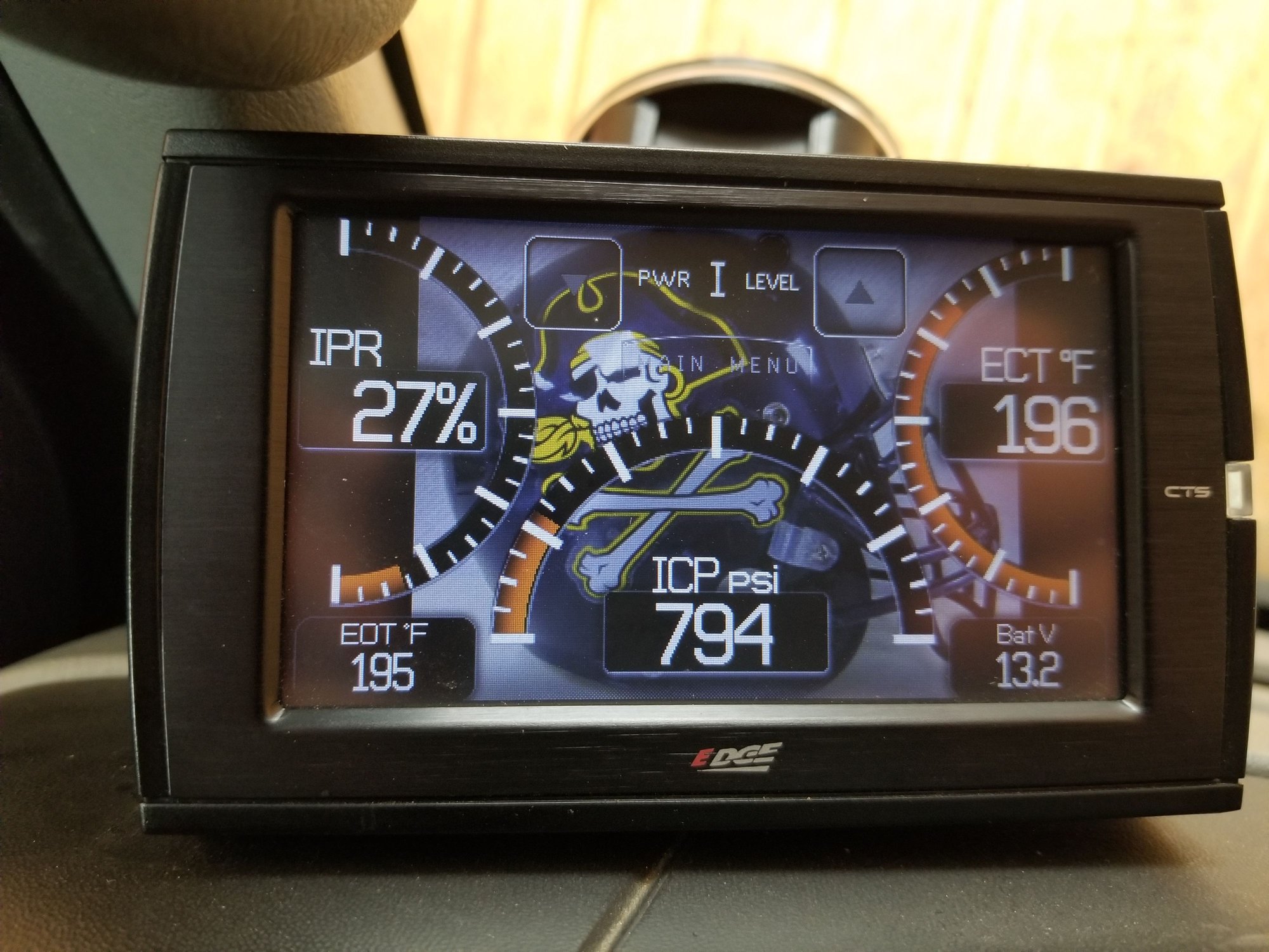

Does this look correct? This is at idle after an hour drive. Ipr% and icp psi?

Typical hot idle you should see anywhere from 580 to 640 ICP....along with 21% to 24%
What is the max ICP and IPR at WOT?

It was 80-85% at work and 1900psi. Is set on a tow tune.

Might want to think about an air test. You should be upwards around 3800 ICP or even more, and at those pressures your IPR would be upper 70's give or take.
Your IPR running that high tells me the PCM is calling for full on oil and not getting it, as seen in those lower ICP readings at WOT.
Any running issues?

Before anymore diagnostics return your truck back to stock. Some tunes will mess with ICP#’s to “trick” the PCM to get different driveability results.
