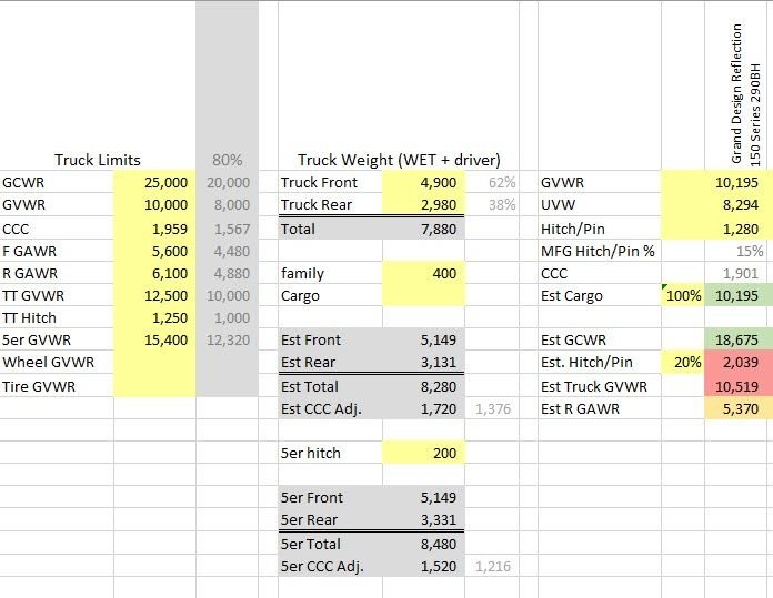

Old Jul 13, 2018 | 01:03 PM
  #65
flysniper's Avatar
flysniper
Joined: Jan 2008
Posts: 211
From: North West Arkansas
10 ways to sunday
Edit to add: I really do appreciate the feedback from everyone. Its been great to read all of the different view points. I only wished I had done this 2 years ago. I probably would have gone a different route with the truck. alas: it is what it is.
I have no interest in being an irresponsible owner/operator. Negligence is nothing to mess with.
I've run the numbers 10 ways to Sunday. And at the end of the day, at 100% trailer capacity (10,195) and 20% pin weight (2,039), I'm 520 pounds over truck GVWR (10,519) and well within the axle limits (5,370) and that includes 400 lbs for family and 200 pound hitch.
At 0% trailer capacity (8,294), 20% pin (1,659), i'm 140 over truck GVWR (10,139). axle (4,990)
My wants and my needs are definite in conflict here.
I guess I just need to man up and make a decision.
Are there 'things' about pulling a TT vs. a 5er that I'm over looking?

Old Jul 13, 2018 | 01:17 PM
  #66
'65Ford's Avatar
'65Ford
Joined: Jan 2016
Posts: 2,672
Likes: 373
I think you have most of it. A fiver is also much, much easier to hitch and unhitch. It's easily a one person job. TT's need two people who communicate well or one person and a good gizmo like a mirror or camera.
Fivers themselves are not necessarily heavier than TT's though their hitch weight is generally a greater percentage of their overall weight. To me that's a plus along with its weight being located in the optimum place.
IMO, you'll be fine pulling any of the campers you listed so long as you're aware of the strengths and weaknesses of each....and I think they've been hashed to smithereens . If I were you, I'd get which ever one of the three campers you like better ...even if it's only for color scheme or the stickers on the outside.
