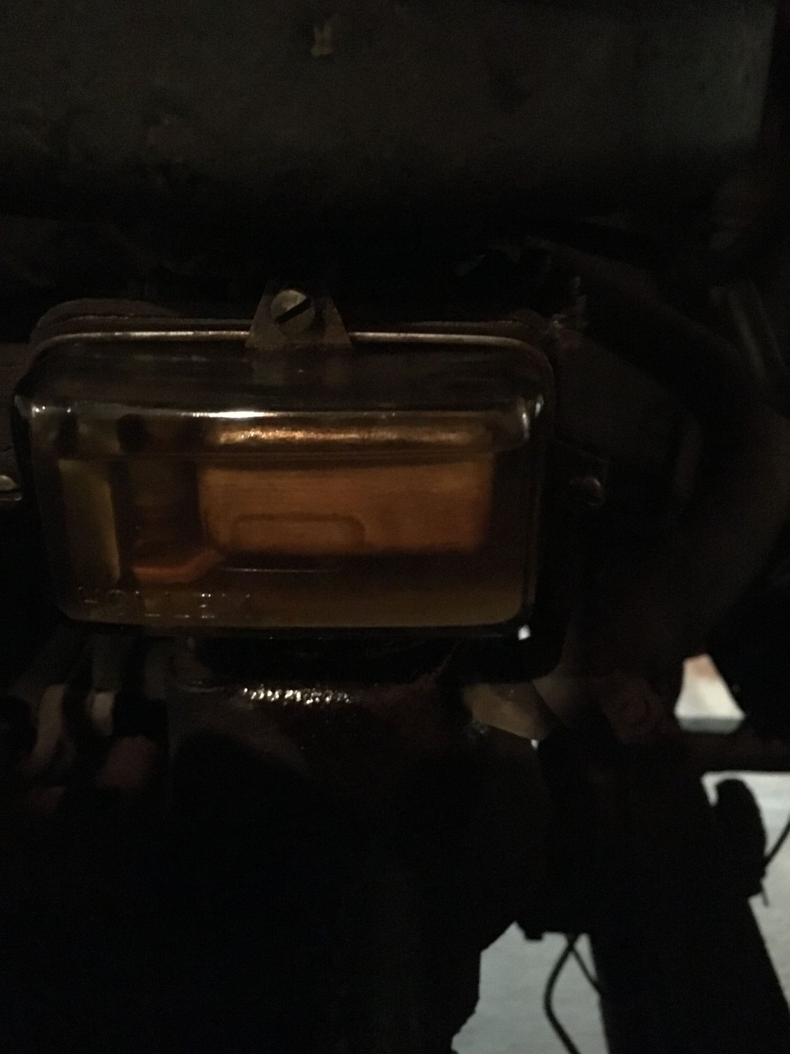

As MixerMan mentioned, I pulled the wire off as he showed above, grounded it and starter turned over. Fiddling around I noticed if the side of the push button touched the hole it goes in just right, it would turn the starter too. Ok have to fix that.
I was able to get the ol girl running and shut it did shut off with the key. Then the engine flooded and would not start. I noticed the glass bowl was completely full, I could hear gas dripping inside. Time to take carb off and clean it using my 10 quart ultrasonic cleaner. Maybe buy a carb rebuild kit. I think I will replace fuel pump while I’m at it too.

The engine is a 215 with Holley carb.
MACS has a rebuild kit listed for a 1952-1959 Holley 1bbl 6 cylinder 215 and 223. I think this is the right one. Anyone know what bbl is?
Bbl is the abbreviation for barrel. A barrel of oil equals 42 gallons (not to be confused with a 55 gallon drum). In this case it's a colloquialism for the throat of a carburetor.
