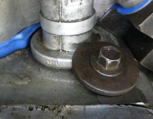

Single bolt with wide washer at the base.

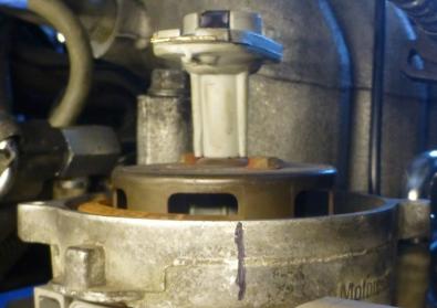

You will not find factory documentation on how to clock the rotor when re-installing, so listen up.
1) At the base of the distributor make a permanent-marker mark to establish the disty housing clocking versus the block. This is your advance-retard setting, which can have a dramatic effect on power and fuel consumption.
2) As you are removing the cap, mark on the housing where terminal 1 would line up.
2) Move the engine to TDC as shown on the harmonic balancer vs pointer up at the front end. The disty rotor will then be pointing approximately at either spark terminal 1 or directly away from terminal 1, in which case turn the crank one more revolution to the next/previous TDC.
3) Now observe more carefully the position of the rotor with respect to the housing. The tip flies by, right to left, and the trailing edge should be pretty darn near the terminal 1 mark. Permanent-marker mark the rotor tip clocking versus the housing, and/or take a picture of it.
4) Take the disty out. Because of the helical twist in the gear, the rotor will rotate as it is remove/installed.

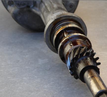

I agree with your assessment -> shaft should not have side-to-side play, should be smooth rotation.

use diesel Ford WSS-M2C171-F1, CK, CJ or CH rated oil 10w30 or 5w30 in the old distributor 3.0L Ford engines. Shafts and right angle gear set last much longer with the much higher antiwear additives in diesel oil. Once the cam distributor drive gear and distributor shaft gear teeth wear out, big $$$ replacement teardown.

Old or new, it would help you to correctly position the rotor when re-installing a distributor. If you're replacing it, I would still make the marks on the old distributor, and transfer the marks to the same positions on the new one.
Just in case you didn't know about changing a distributor: The position of the rotor will move about 30 degrees from where it was before pulling to the point where its gear disengages from the cam shaft. So you might want to mark that position as well to set its starting point when you're ready to actually put it into the engine. This makes the installation easier when you're trying to engage the cam shaft AND the oil pump drive shaft while trying to stab it into the engine.
