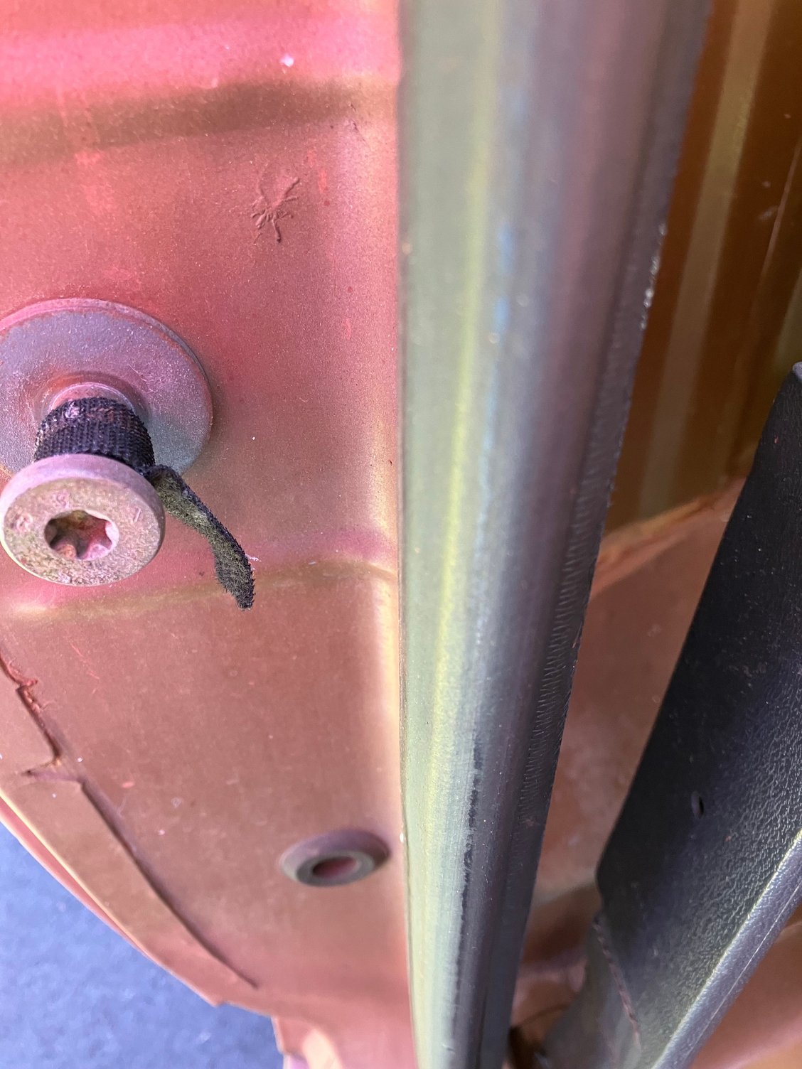

LOL, really, I can't believe it was that easy to fix. I just put a piece of Velcro around the pin and took the truck for a ride over the bridge and train tracks...no rattle. I may trim off the excess...
I used a old piece of Velcro that I had laying around the tool box, that I took off some wires I had Velcro'ed together.

I've tried to lift the doors when partially open, there is no play in them. I'll use the Velcro for the time being. I have plenty of that.
