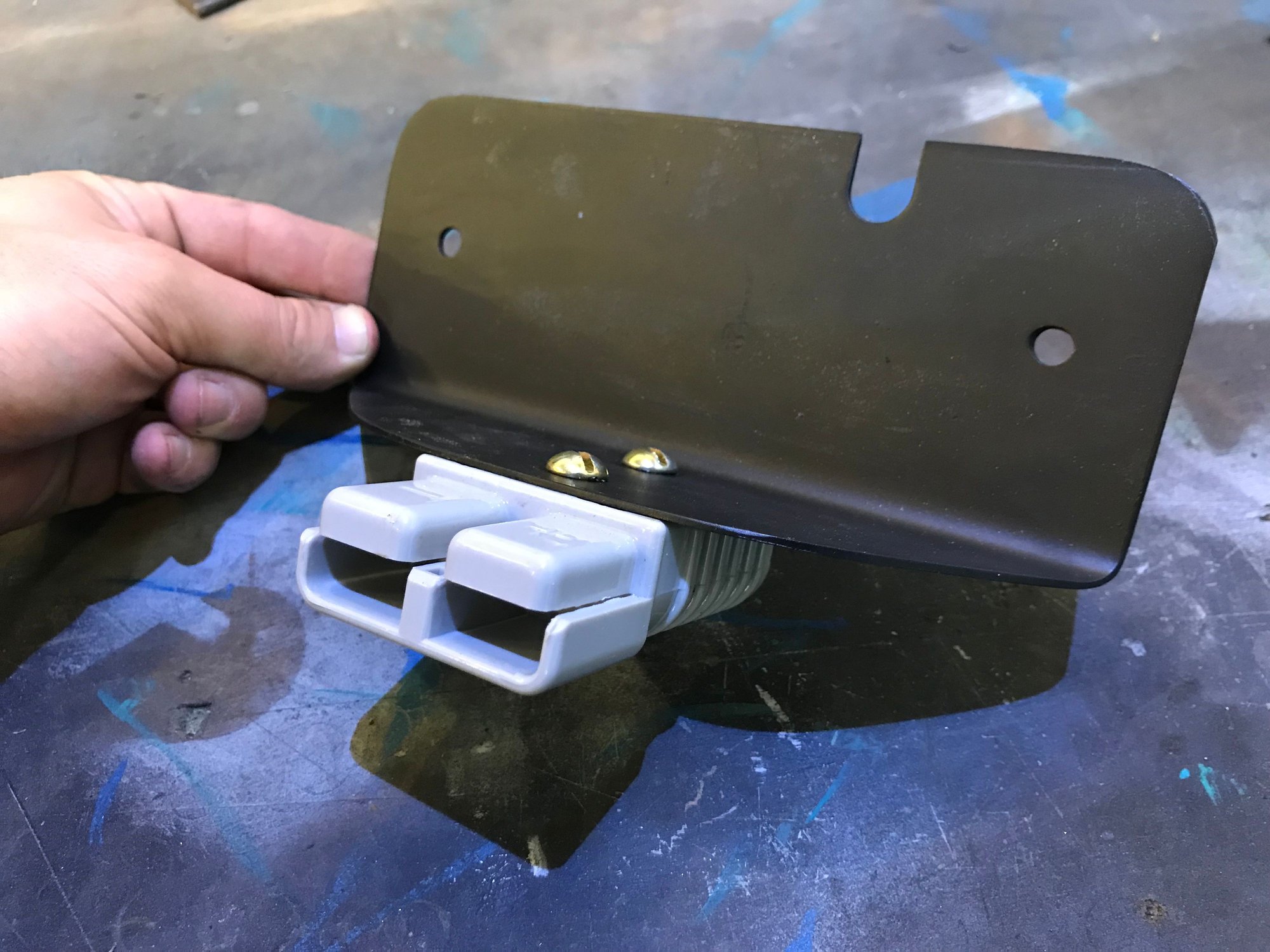

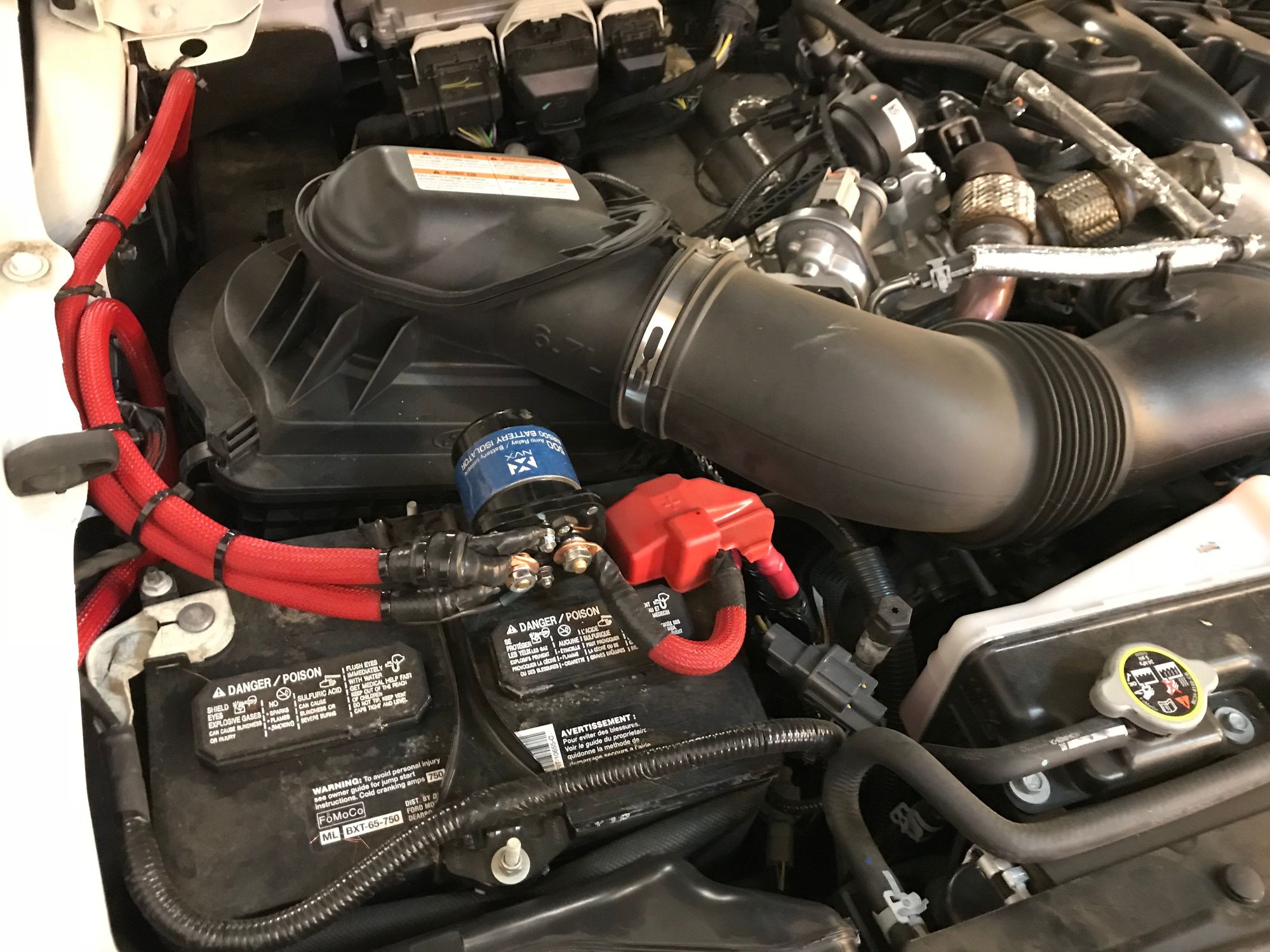

Just make sure your alternator can handle the load. What alternator capacity do you have? I do the same thing on mine ('17 450 with dual HD alts). In the summer, I actually run the AC going down the road when its really hot and the dogs are in the TC. And yes, it's great at a rest stop. Just keep the truck running and power the AC on the inverter. I usually keep the fridge in AC mode while traveling too. (Though if I run the AC I switch the fridge back to gas and minimize all other AC loads). Microwave works great too (not at the same time as the AC). I have a 2500W (continuous)/5000W (surge) inverter. 1/0 gage wire run from truck battery to a quick disconnect in the bed, with 1/0 gage coming from the TC batteries to another quick disconnect fitting. The cabling is isolated from the battery by a 500A continuous duty relay right at the truck battery, controlled by an upfitter switch. No generator to carry around, as the truck's alternators serve the duty.
2500 Watts at 13V is about 192 amps. Figure another 50A for the truck (lights off, heater blower on low, etc). Rough numbers say you'll want a 250A alternator (or bigger) to run continuous without discharging the batteries. Or, accept a little battery discharge and only run it intermittent. Key is, you need to supply that 200 amps to the TC's batteries - must wire a heavy 1/0 or 2/0 cable to do so.

Here’s my electrical setup fysa. Next project for me is a 500a in-line fuse

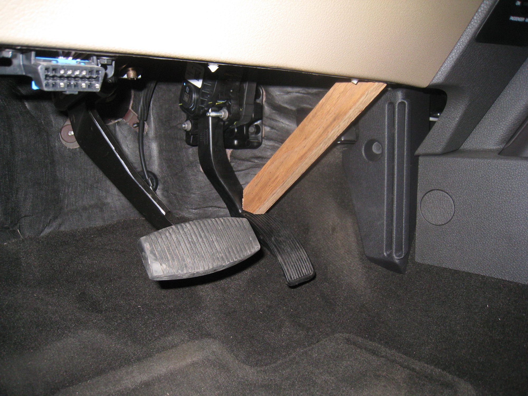

Temporarily

Originally Posted by pack4tag
Temporarily
That’s old school right there!
