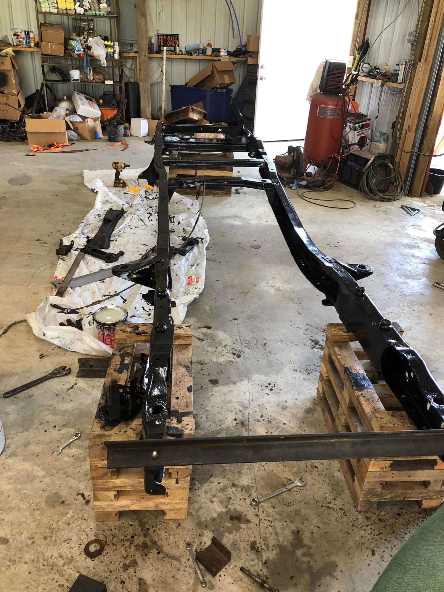

We have used POR15 on the last 2 trucks we have built. It’s good stuff, but like everything else, prep is key.

Did you have the frames sandblasted first or did you follow the method POR had (remove paint and flake rust, Cleaner Degreaser, Metal Prep, POR-15)? Does POR-15 come in gloss only or can you get a satin black color? And did you have it top coated with POR-15 Top Coat for UV protection?
