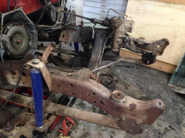

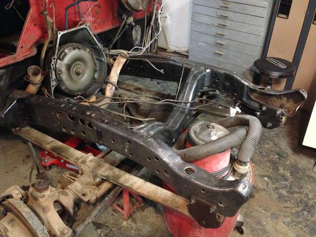

From my build thread: Post #150 1979 Ford F-250 4x4 Build Thread
BEFORE:
Attachment 285044
DURING (after cleaning and applying POR-15's Metal Etch):
Attachment 285045
And now, for some TV magic. Boom. One heavy coat of POR-15. One heavy coat of Chassis Coat / TopCoat by POR-15. This image makes me happy
Attachment 285046
Attachment 285047
Spent the extra time with a tiny brush and my tiny hands... hours and hours of prep and painting paid off... And it'll hopefully it'll last forever.
Either way, every time someone looks under my truck they comment how clean it is.
