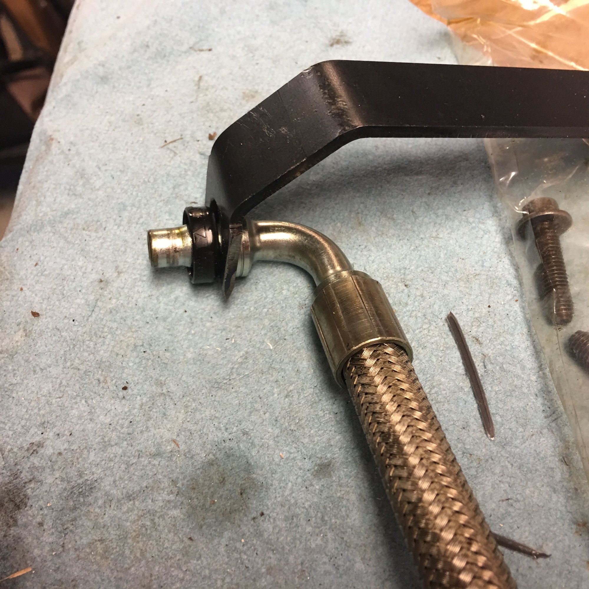

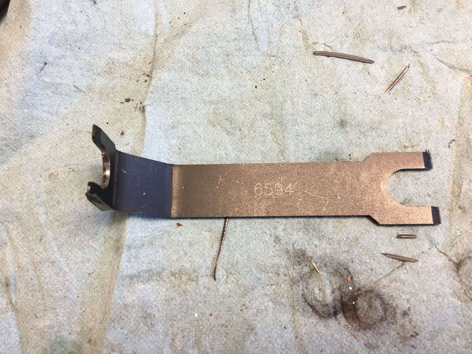

I’ve got the rail tool, but some angle grinder wrenches work too. Before I got the tool I used a flat screwdriver.

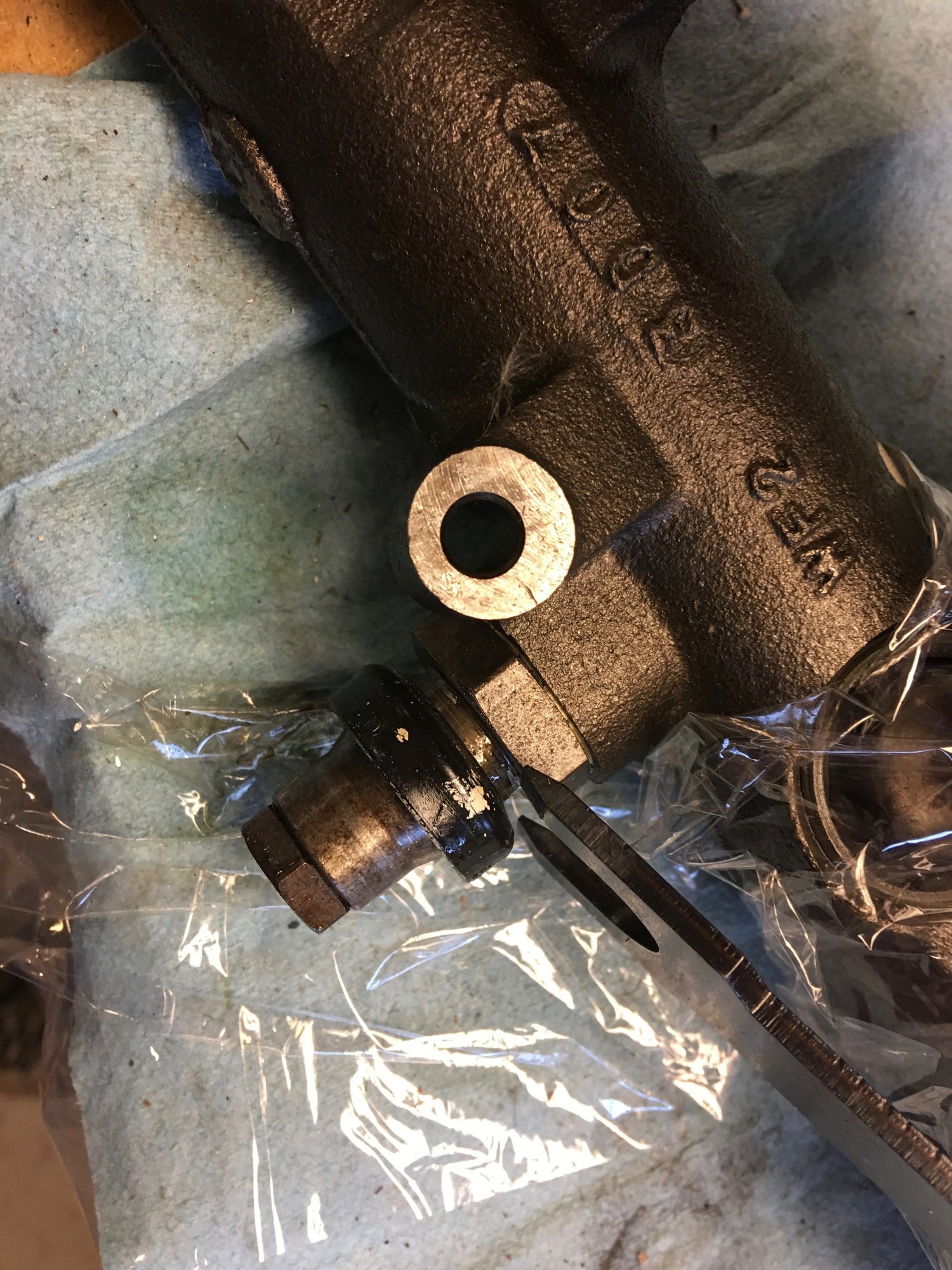

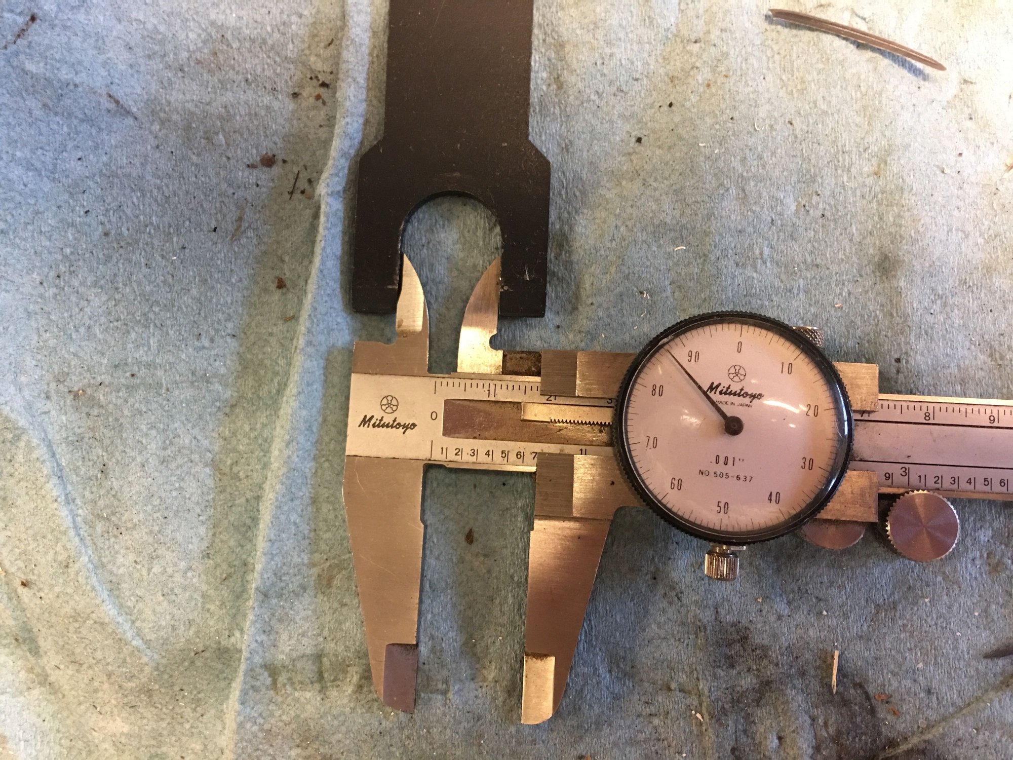

I'm just going to dump all these pictures as Im in the middle of painting a room. I modified the tool to do something else so the one opening is larger then stock, but it still worked.
