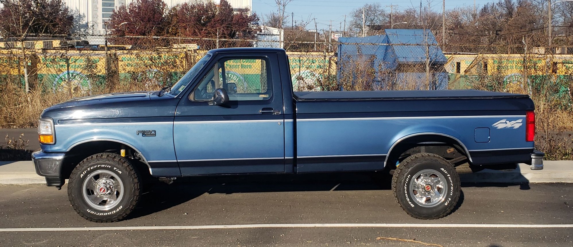

Well I decided to go ahead and put the cab lights on my truck. I​​​​​​ like them, so on they went. I measured them out very carefully using the measurements that Diesel Brad provided in his DIY and drilled the holes with a 7/64 bit, then drilled the center holes out to 7/8 with a step bit. Fished the wires, touched up the holes with some touch up paint, and put the housings on using #8 stainless steel screws with a dab of RTV on them. I bought 5 new housings from NAPA but they only had two in stock, so the other 3 will be here Monday. I used three of the old ones for now until the new ones come in Monday and I will get this job totally done. But I'm very happy with the results, I think they came out great. Thanks for the input everyone!

Awesome- great job.
Is it an visual distortion or are you missing the stripe at the two tone line from the doors back?

Thank you. Yeah I never put the pinstripe on the rest of the truck after I painted it. It only takes a couple minutes to put it on. I'll get it done sometime, just hasn't bothered me that much.

Thanks, I'm glad I did them, seeing the orange glow that reflects off the hood at night makes it all worth it. It's a fun job to do when you are bored and have a 6 pack of beer laying around.
