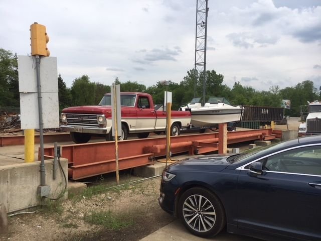

I am towing a 20" boat w/ trailer that I would guess weighs in at 4500 Lbs. 390 w/ C6 tows with no issues as long as I stay on main roads to keep the speed up for airflow and avoid slow country roads with numerous stops and turns on VERY hot days. Ask me how I know this!
