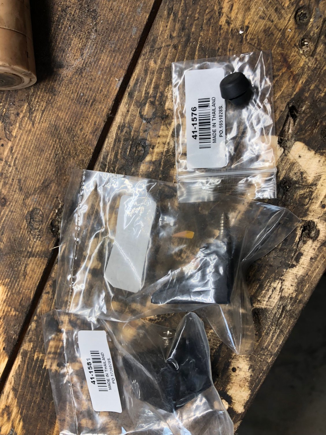

I just ordered the tailgate bumpers and snubber ( correct name?) since are gone hoping that ill fix most of my rattling from the tailgate.

I haven’t drove the truck yet but just by adding the round rubber stoppers it made a big difference.

I ordered the parts from LMC trucks the part numbers are in the picture.
I hope this helps your issue.
