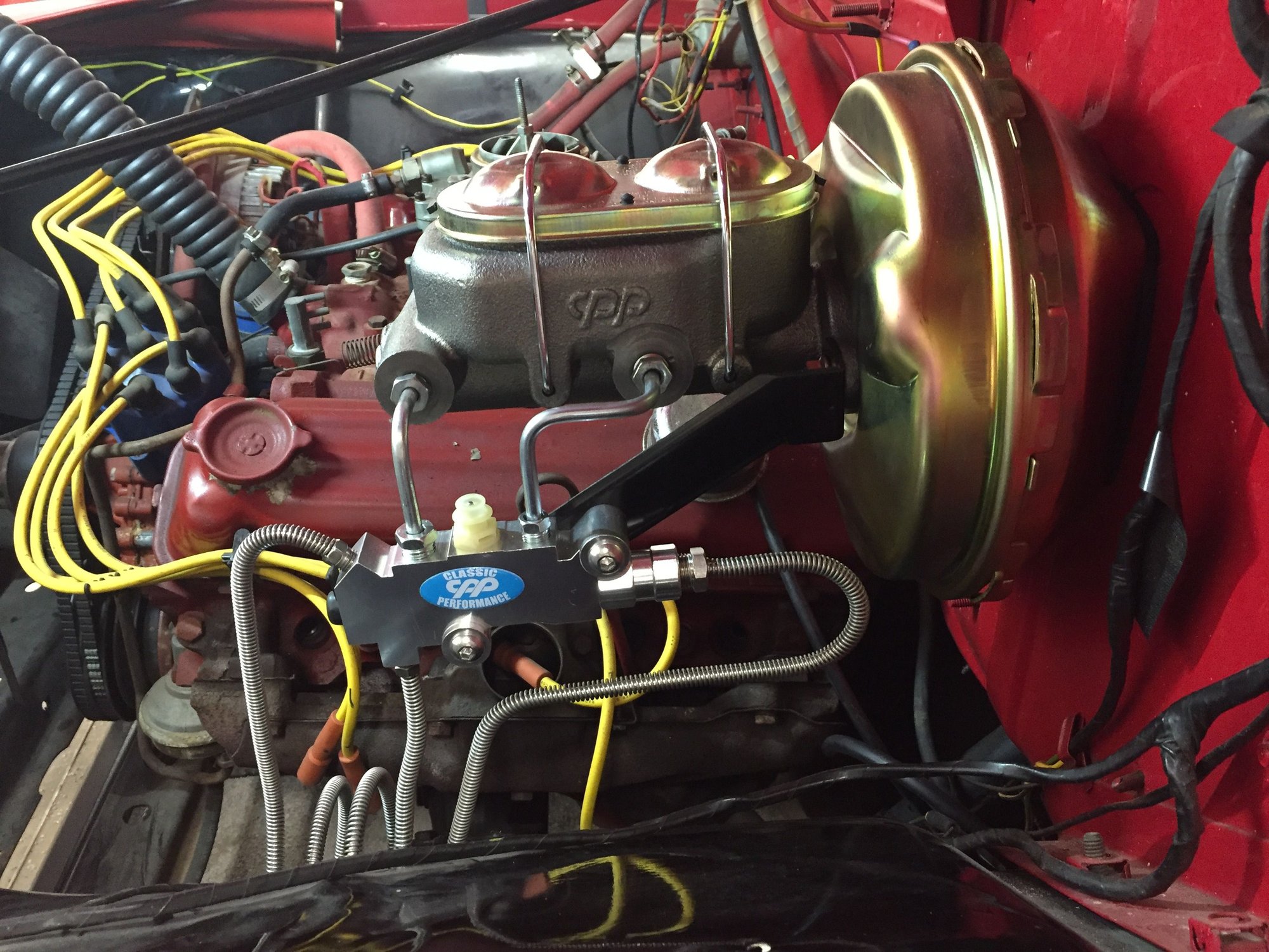

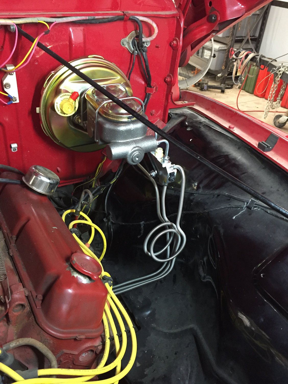

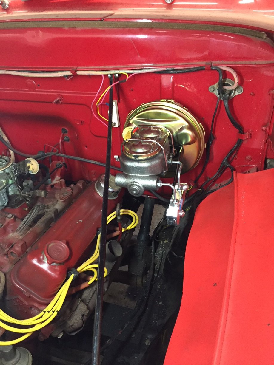

Spent a few hours today installing the new brake booster & master cylinder. Now I need to research which end of the proportioning valve is for the front wheels.

Front port is for the front wheels..

Nice setup. How did u run the front brake line for the front from the master cylinder. That my next step and was wondering how u attached the front brake hose to the frame

The old flex hose used a nut that threaded onto the fitting that stuck through the frame. The new hose uses a clip that attaches to the fitting (see image). I have yet to run the brake lines from the master cylinder.

All the brake lines have been replaced and the air has been bled from the system! The lines from the master cylinder were very time consuming! I am glad that is behind me😀

Maybe I'm seeing it wrong but should the rear line on the master not run to the front brakes ?

I hope not... or I did it wrong! Why do you think so?
Edit: I called Mid Fifties and they verified that the rear port of the MS/Prop valve is for the rear brakes.
