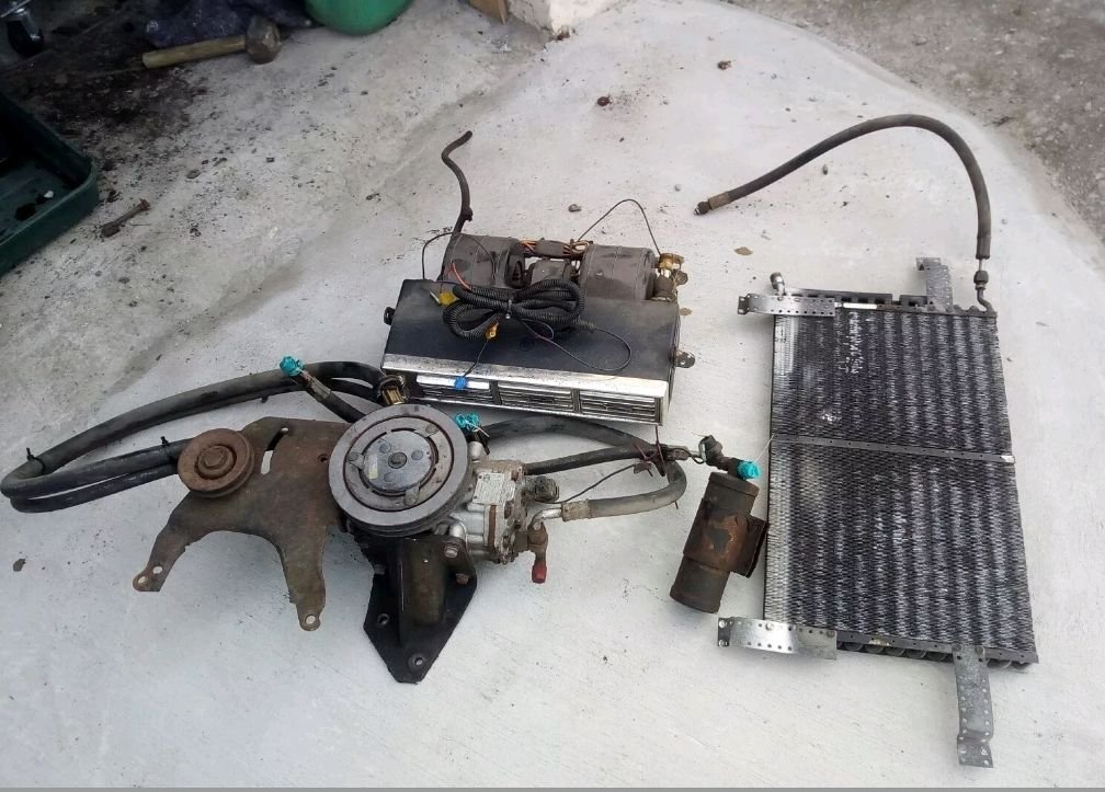

Hi All,
This is probably going to start off as quite an open question - hopefully someone will be able to give me some pointers.
I have just bought a used aftermarket AC unit for my truck, the compressor and mounts are meant to be for an FE. I have a 390.
In the cab there is an under dash blower unit, which should be easy enough to install.
I also have a cooling radiator for it.
My question is - do these mount in the same way as the stock factory AC did, and if so, does anyone have any good diagrams of assembly instructions.
Where should I mount the extra radiator?
What size bolts should the brackets mount to the block with (and how deep to go?).
Thanks in advance,
Dean

The condenser bolts on in front of the radiator near the bottom.
The compressor mount bolts to the holes in the left head, the idler pulley bracket bolts to the water pump.
I'm thinking the bolts for the compressor mount are 7/16 and should stick through the mounting bracket a min of 1" to 1 1/4"
Looks like the idler pulley bracket will bolt on using two of the existing bolts that hold the water pump on.
Normally this system requires a 3 grove bottom crank pulley that I don't see in the photos, check to see if your engine has one.

If that's a York compressor I'd look at getting a Sanden or adapt one from a newer vehicle.

That's definitely a York. Anyone need an air compressor?

Besides being heavy, they are horsepower hogs compared to newer units. Buddy of mine adapted the compressor from a Toyota and the engine doesn't even know when it's engaged.

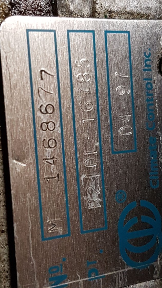

I've been a bit quiet. Thanks for the replies.
This is all I've got at the moment, so would like to get it working if I can. - getting suitable things here in the UK is quite difficult (or so I thought, but it sounds like there are a few newer options?!)
In terms of identification, here is the tag
I don't see York or Tecumseh?
I think I only have a 2 groove crank pulley, I will check later.
Will I be able to work out for sure if I need a 3rd groove before getting it on and seeing where it lines up?
Old Jul 1, 2018 | 09:26 AM
Destroked 450's Avatar
Destroked 450
Joined: Dec 2015
Posts: 2,545
Likes: 324
From: Harned, Ky
I worked on a few factory setups back in the day and that where all pretty much the same.
1st groove was for the alternator and water pump belt
2nd grove was for the power steering belt
3rd groove was for the AC
There where exceptions for models with dual groove alternators
You can hang the idler bracket on the water pump and look straight down the idler fully, that'll give you a good idea of what you'll need.
