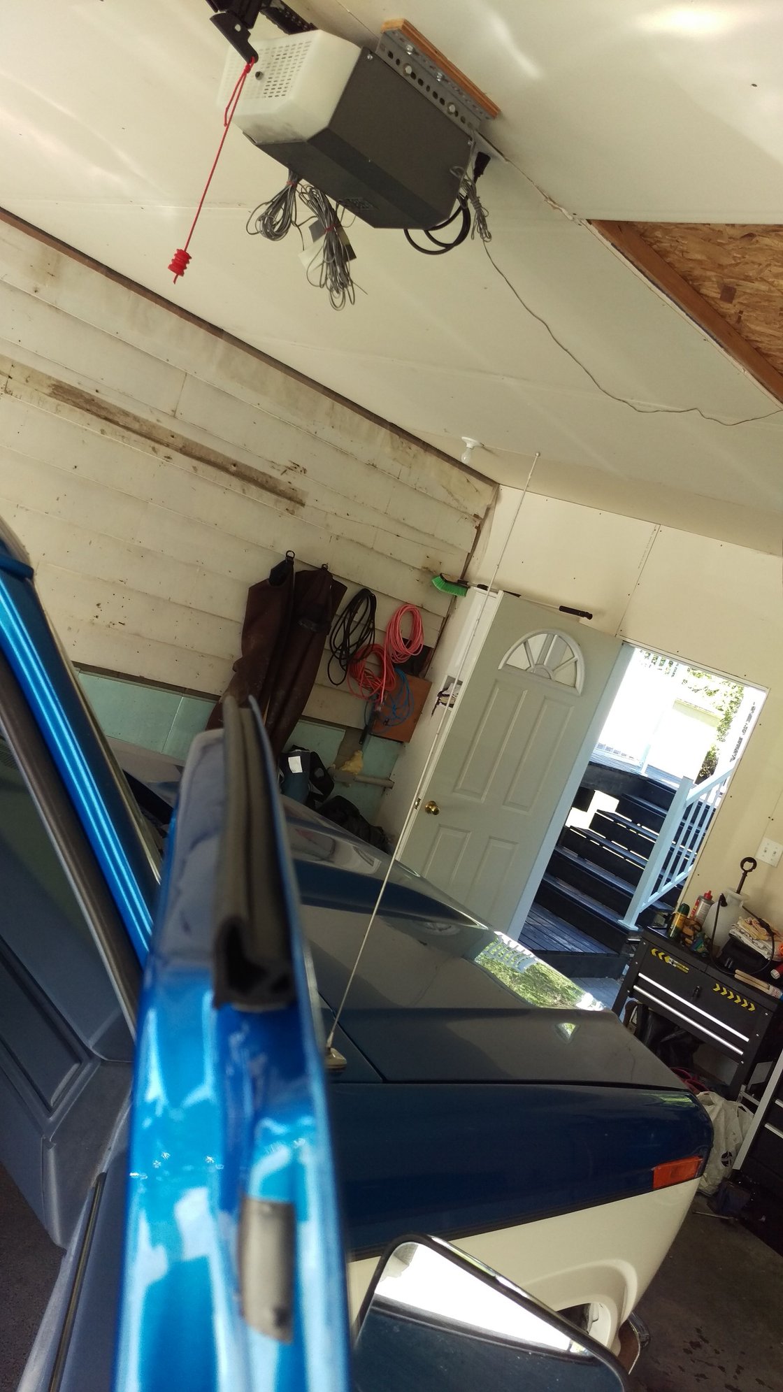

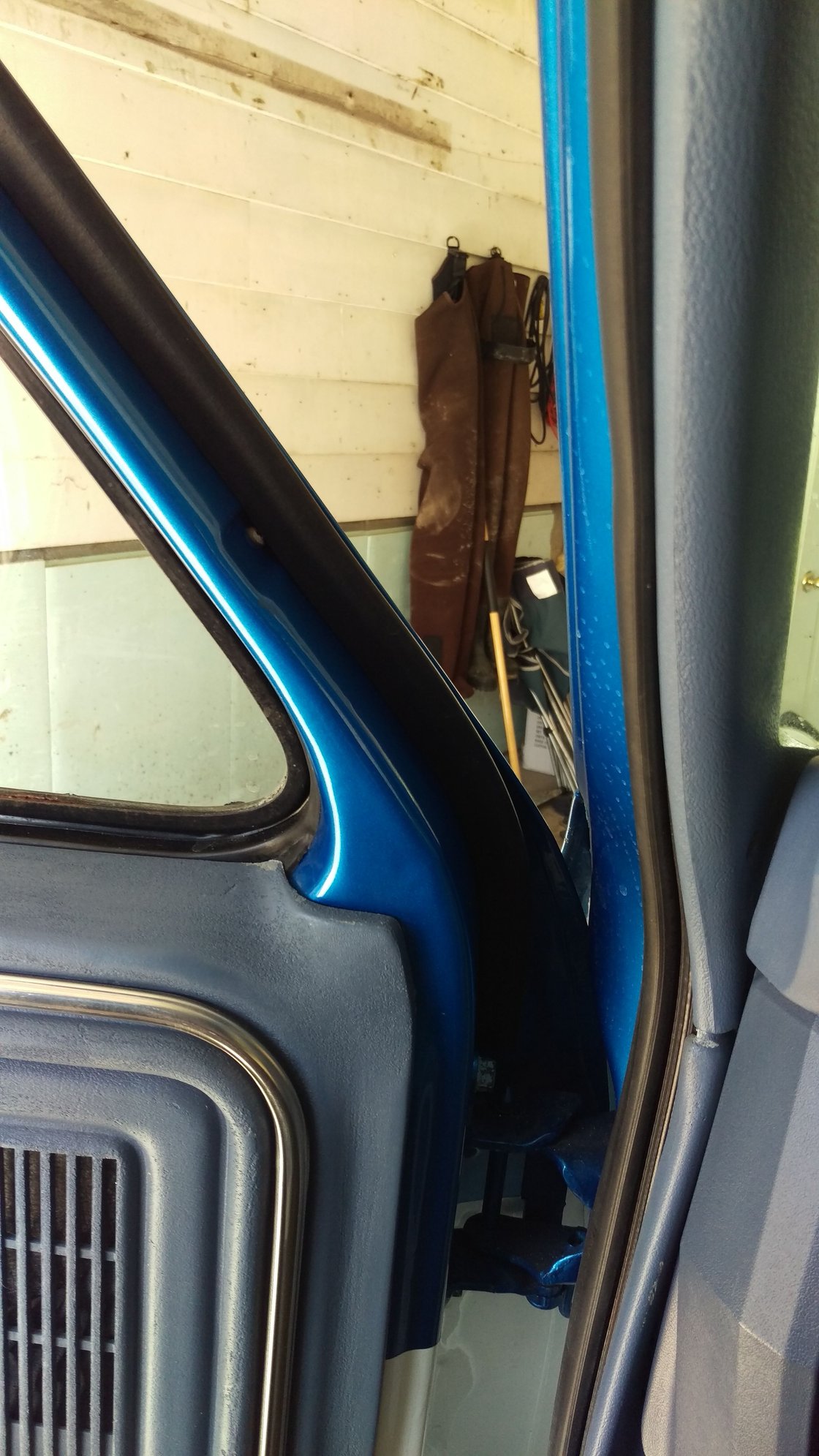

Just thought I would give this thread a final update. Finally got around to installing the upper seals on the doors. Install is very straight forward as it is just peel and stick. I wasn't sure which direction they went at first so I referenced some pictures on another forum and then stuck them on. Hopefully they are the correct way. From what I can see they press up against the cab nicely when I close the door so it should do something. Unfortunately I haven't had time to take it for a drive yet. I just finished replacing my brake master cylinder before going back to work for 5 days now. Anyways, here is what the final product looks like.
