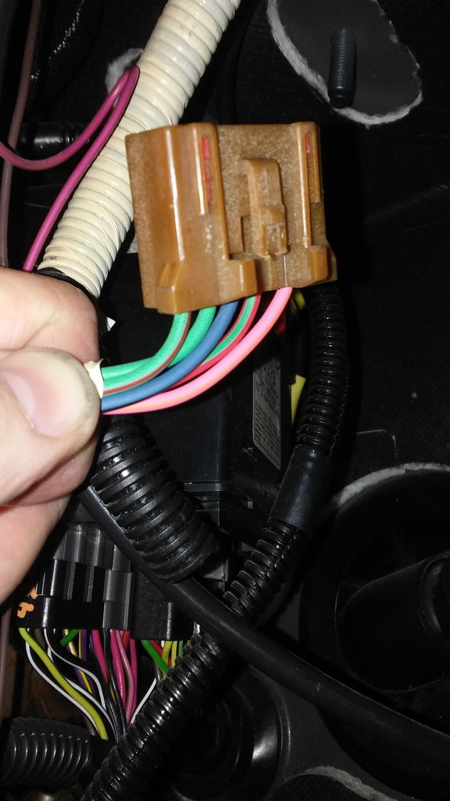

Ok, so curiosity got the better of me. I went out to my truck and started it (FYI it is 95 degrees here so you had better appreciate this), I put my foot on the brake pedal and moved the shift lever out of PARK. I put it back in PARK and crawled under the dash to the brake pedal and unplugged the connector. I pulled my way back into the seat and pressed the brake pedal and tried to shift from PARK. No go, shifter wouldn't move. I didn't try to force it because I didn't want to damage it. I went back to the brake pedal and plugged the connector back in. Back to the seat and pressed brake pedal and shifter was back to normal.
Therefore one of the wires from that connector allows the shifter interlock to allow the shifter to move when the brake pedal is pushed. So a simple disable would be to figure out which wire and cut it. Take each end of it to a simple toggle switch, NOT THE UPFITTER THAT IS POWERED, and when the toggle switch is on, the column shifts like normal. When the toggle switch is off, no shift.
I can not get it to print out, but if I am reading the wiring diagram correctly for my 2006 the RD/LG wire is the one that goes to the shift solenoid that allows the column to shift when the brake pedal is pushed. No I am not curious enough to cut my wiring to test this theory.
Yes, I broke the little tab doing this experiment.
I am sure Yahiko can get you the wiring diagram for the Shift Interlock for your truck if you ask.
