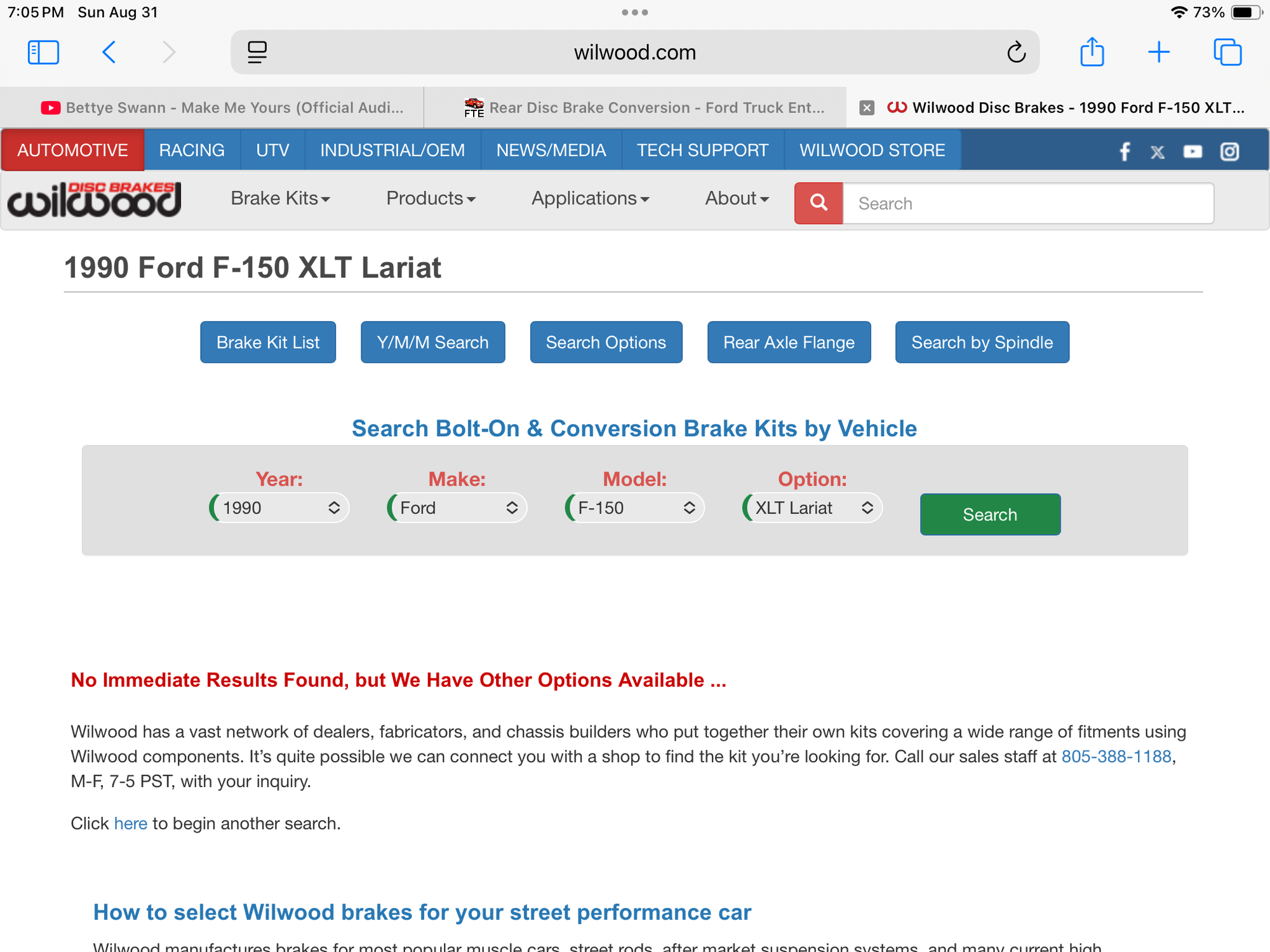

I know this is an old thread, but as an owner of a 1990 f150 4x4 302 lariat, I was curious as to the company thst you mention as I tow a boat.
its not that heavy a boat 2500lbs, but brakes are first and foremost for me so I went to wilwood ( thanks I never heard of them before).
apparently, there is no longer an immediate bolt on upgrade to the front brakes, guess i am 15 years late looking at this thread.
