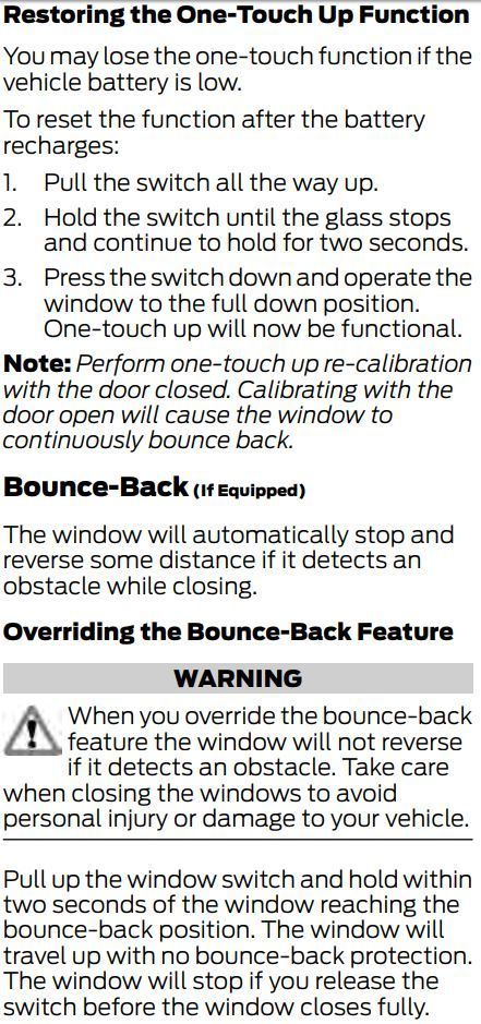

Sounds like the bounce-back got activated - saw similar thing when I put my wind deflectors on.
Not sure if this is the fix, but worth a shot. Make certain the door is closed when you do the procedure.

Jake,
Thanks I tried both last night but was tired so I just went out and tried again. No Luck.
Takes 5 pushes of the switch to get the window fully down. 7 pulls of the switch to get the window fully up. The windows stops the exact place going down or up. Very strange? I will take back to dealer Monday if I can make the time. I'll report the fix in case someone else has the same problem.

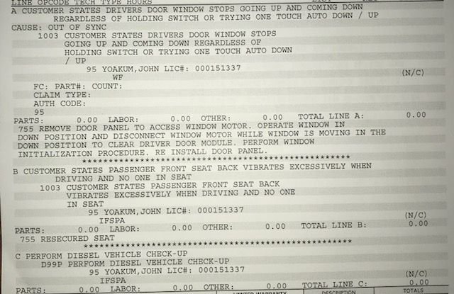

Truck is back and fixed. Below you will find what was done to correct the strange window operation.

so looks like the sensor module needed re-setting. That what I’m reading?

Yes that's what I was told. The window motor needs to be unplugged while the window is on its way down. Strange way to reset but who cares its working now.

Wonder why you couldn't, just pull the fuse for the widow motor, while the window was on the way down?

With as electronically involved as all these new vehicles are, the fuse that the window motor operates on probably runs a host of other features as well. No need to disrupt a half dozen other circuits...
