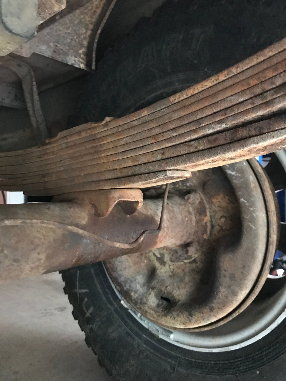

Anyone have a source on the large bolts that attach the leafs to the rear axel?
Having a difficult time finding the right size set.

Sry, I have a 67 250

2WD or 4WD? How many leafs do the rear springs have?

4x4 and 9 springs. Thanks!

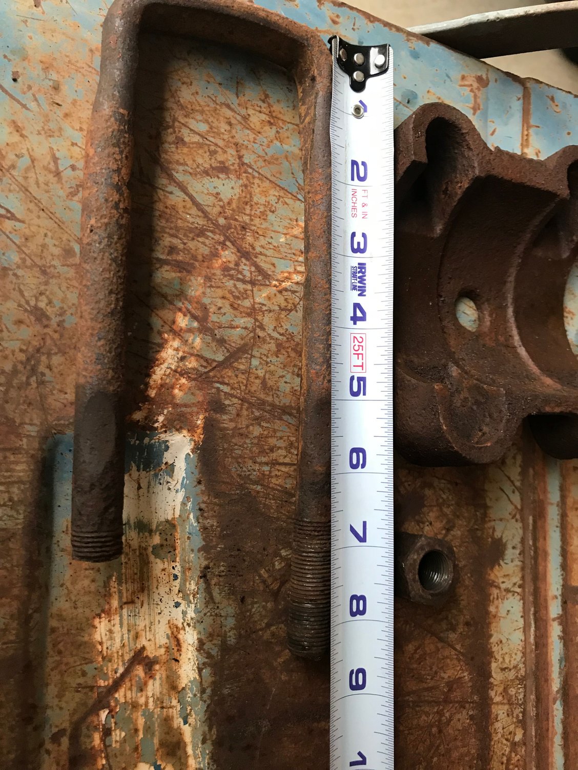

You want the U-Bolts (basic part number 5705), correct?
That's right. Need the nuts also. Going to have to cut these off. None of them will turn.

Check that. 10 leaf springs.

C7TZ-5705-A .. U-Bolt / Obsolete
1967/72 F250 4WD & F350 // Pic: C7TZ-5705-A specs: Column left, 5th entry.
GREEN SALES CO. in Cincinnati OH has 19 = 800-543-4959.

Any decent truck repair shop can make U-Bolts on the spot while you wait, any length required for not too much money. Bring one in so they can compare, there are "square" and "half round" designs, they look similar but won't clamp right if the wrong kind is used. Check torque again after a few hundred miles, after they settle in.
