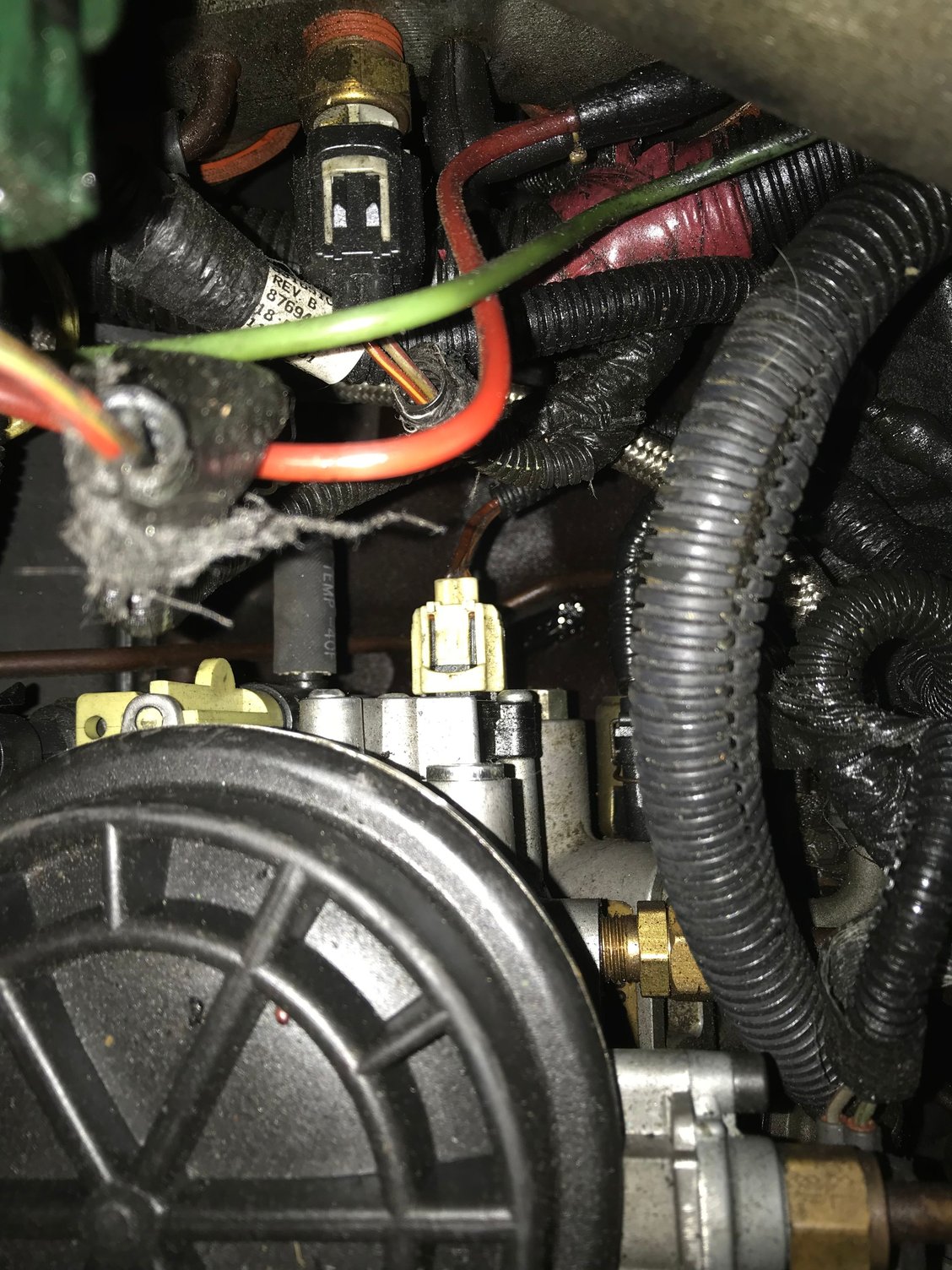

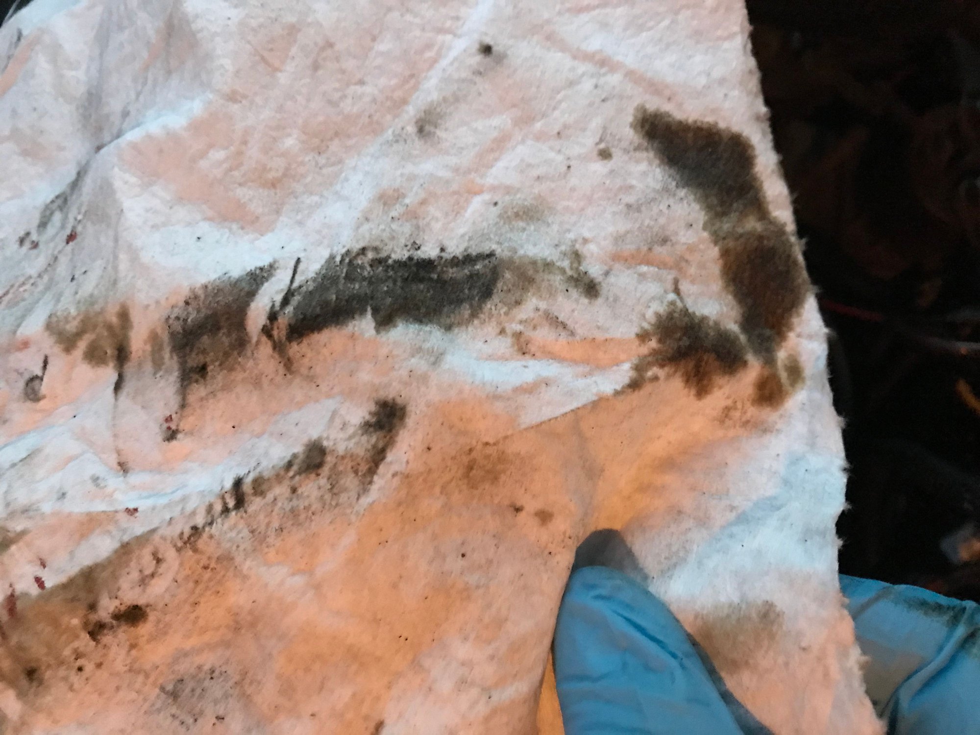

One of the issues is oil/fuel in the valley I can’t tell what it is, there’s very little of it.

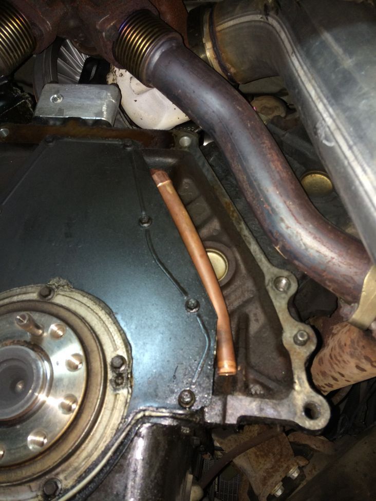

I read 2 different posts one used 3/8 copper and one used 1/2 inch any idea which ones correct?
Old Jun 6, 2018 | 04:58 AM
Bill Kay's Avatar
Bill Kay
Joined: Mar 2013
Posts: 523
Likes: 9
From: Carrollton, Ga
1/2” soft wall copper and 90* fitting from your local hardware store is what you want.

The 90* fitting is loose in the hole in the back of the valley. I just siliconed around it to seal it but I often wondered if you could swedge a piece of the 1/2” tubing to make a better seal.
