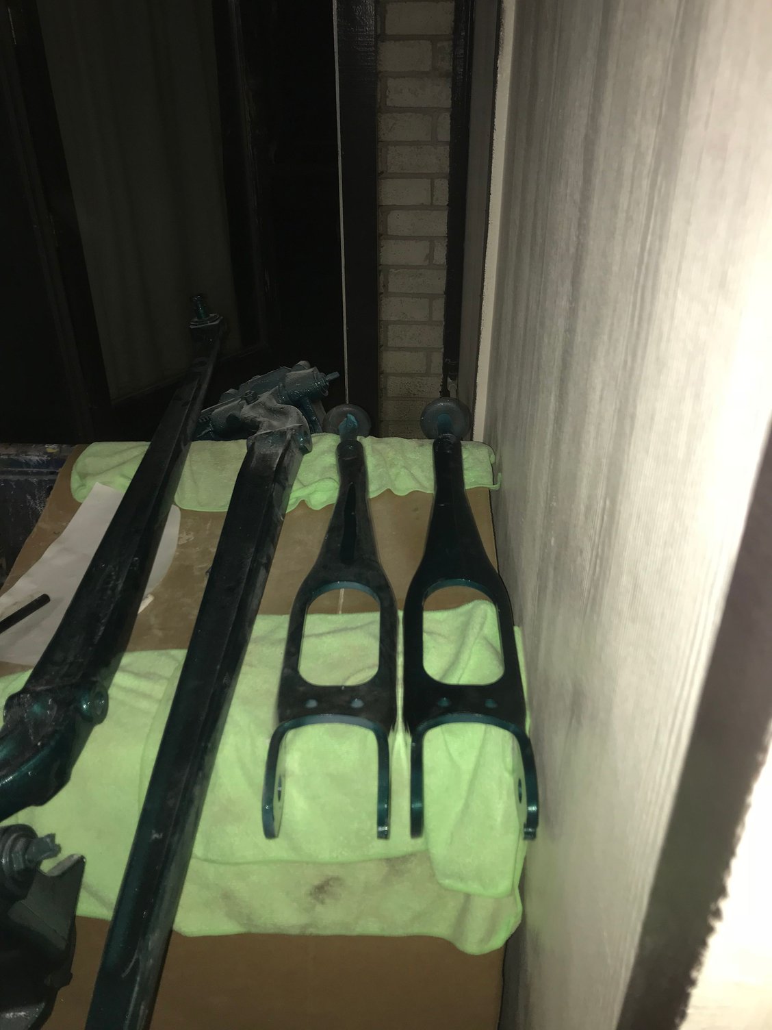

1969 f100 with a 1979 f150 disc brake, standard cab, long bed. The original arms have a drop in them near where the arms attach at the frame. One of the f150 arms appear to have a drop and one does not appear to have the same drop.

Only the lower shock mounting brackets (bolt-on items) are side specific. The arms will work on either side though.
'65-'73 radius arms are forged steel. '74-79 are stamped steel. '74 stamped steel radius arms have no notch in the forward end for a factory '75-'79 front swaybar endlink bracket (but, the notch can be added to them). All '75-'79 radius arms have the notch in the forward ends of the brackets for the addition of a '75-'79 factory front swaybar.

Notice the one on the left has a kink in it?
Yep. The radius arm on the left is bent.

Yes, by design. I’m trying to figure out which side and orientation it goes on.
The open "U" shaped channel faces outwards. Those are at least '75 model arms, as denoted by the notches at the forward ends of the arms. The radius arm on the right side of the truck will have the notch oriented at the bottom. The notch on the left arm will be oriented at the top when it's installed.

The radius arm that's bent in the photo is the one that should have been on the right side of the truck.
The lower shock mounts should be stamped "RH" and "LH".
