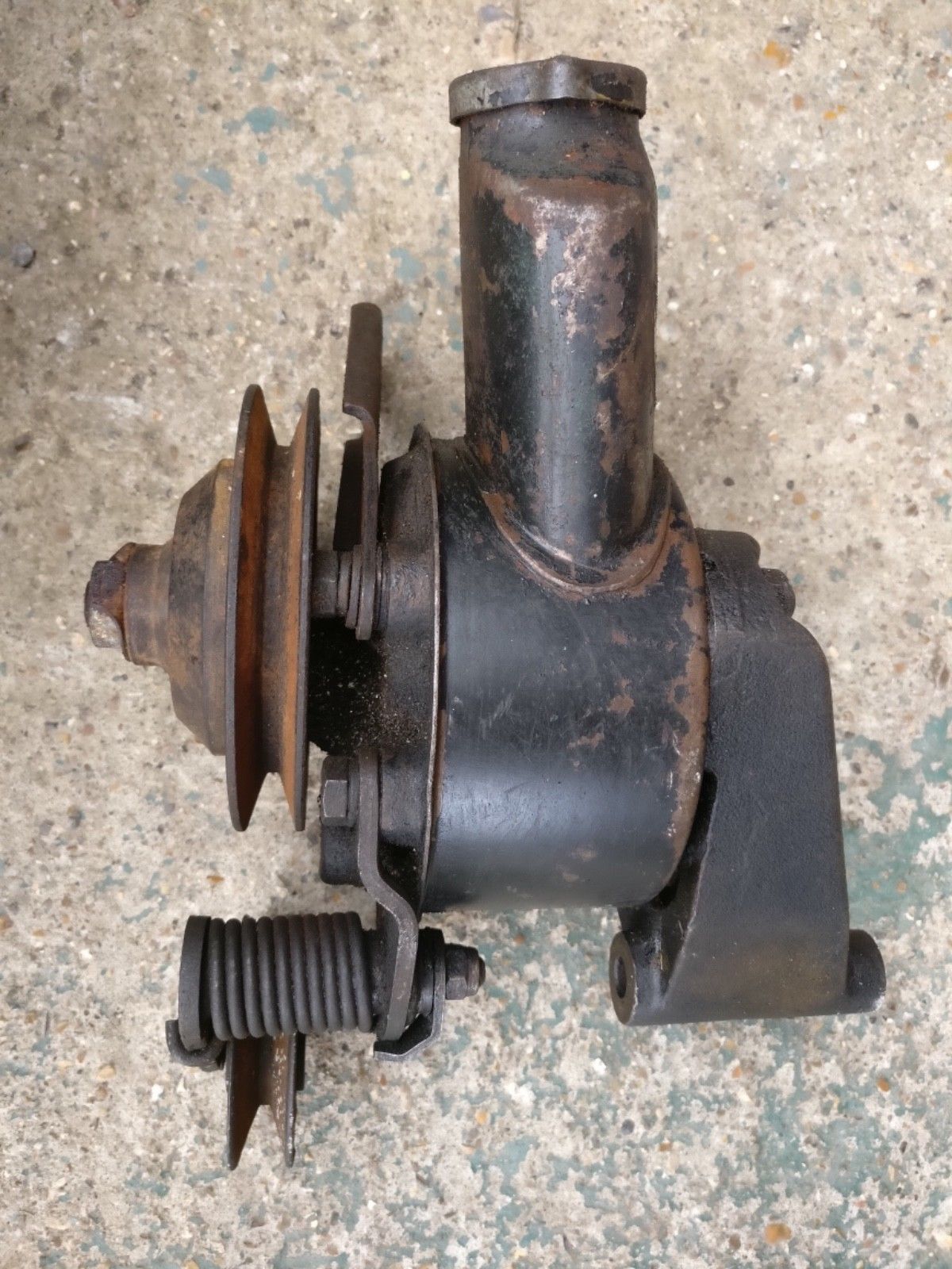

I have never heard of boiling the fluid, if you were running too much pressure you would either blow the seals or have over assisted steering IMO. I run GM saginaw pumps with my jag racks and have had no problems. The Ford pump in the picture looks like a saginaw pump as well, maybe there is something wrong with the rack that is causing the fluid to heat up? Either that or the pump is creating the heat? How about looping the pressure and return lines on the pump and bypass the rack completely? Then you can see if the pump is creating the heat.

The ford pump in the pic is a saginaw but not mine , and yes I have never heard of oil that hot but it melted the cap . The pump was fine on the donor. Both lines were hot when it overheated and the steering seemed to be working properly as I ran it lock to lock a number of times . So I am as confused as anyone .
