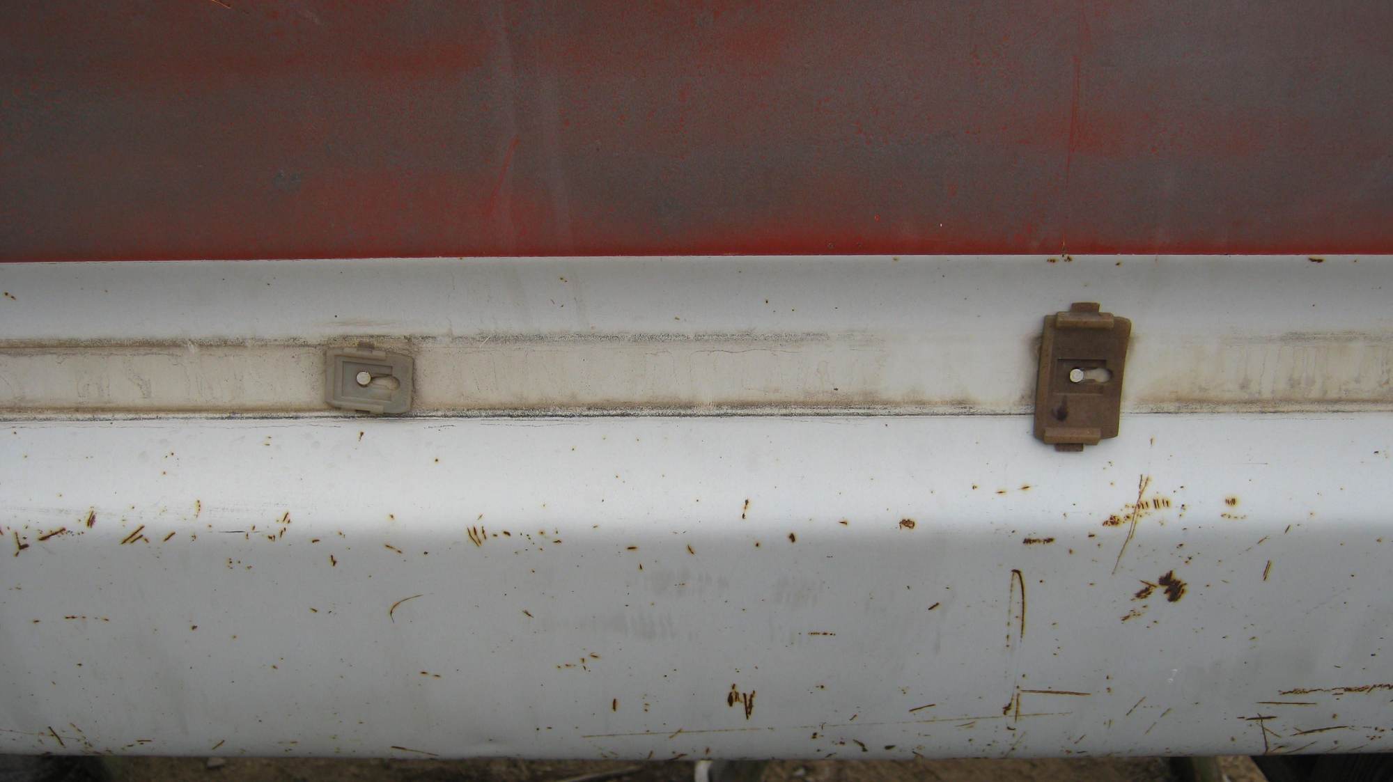

narrow and larger molding plastic retainers
did you use pop rivets or riv-certs,what ever their called,,,my fenders have existing nubs as well as my bed,not my doors
