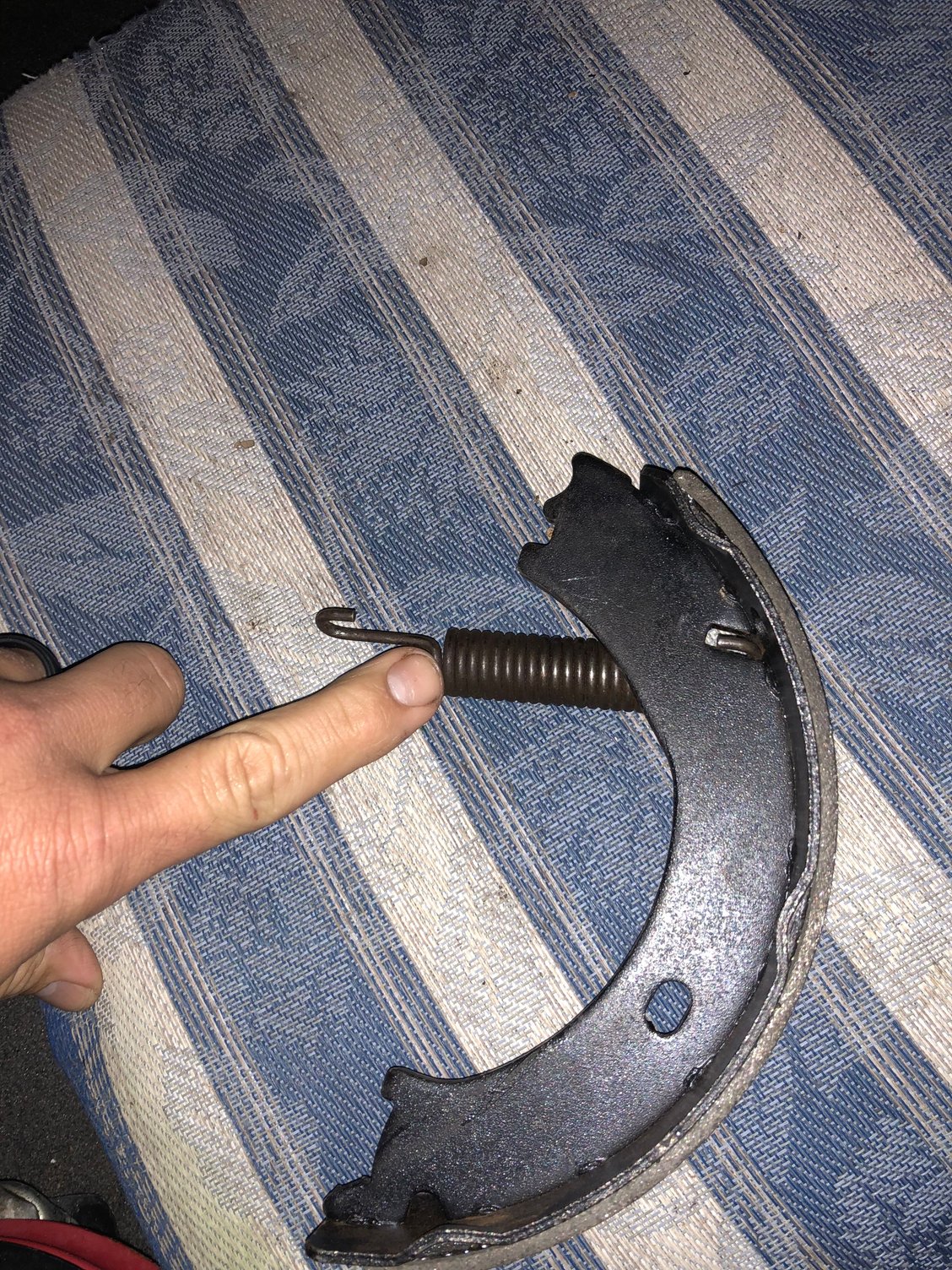

I decided I would install rear pads and shoes on my truck. My emergency brake has not worked in a year and the shoes are really wore down. I can not figure out how to get the upper inner spring installed on the passenger side without removing the axle. I have worked for 2 afternoons and I am ready to pull my hair out. Would I run into any problems if I put it back together without the shoes on that side for a few weeks until I have time to get it fixed? I know I would not have a emergency brake but I have not had one for a year now. Thanks

I know it sounds simple but the spring on my truck is so fat it just will not fit. I had someone help me do this but I can not even begin too stretch the spring enough to fit. The passenger side upper is way bigger than the driver side upper on my truck.

Pic
can you take a picture of the shoe and upper spring and another with you trying to slide it over?

Top springs are the same left to right as well is the bottom left to right. Someone changed your hardware

This is as far as I can get due to spring size
the drivers untouched side with smaller spring

If this is a aftermarket spring could I just go to a auto store and get the correct one?

Yes. you can go to the parts house and get a hardware kit that would take care of both sides. It's not that much money and saves a lot of headaches.

The new shoes should of come with them
