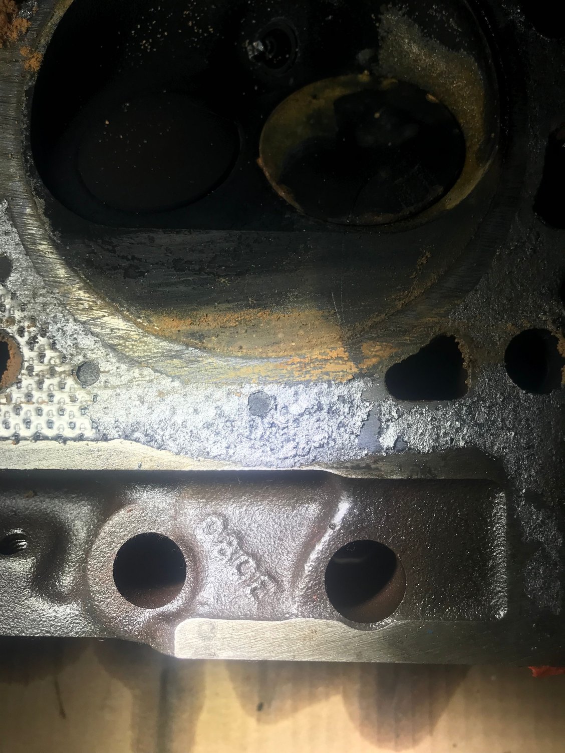

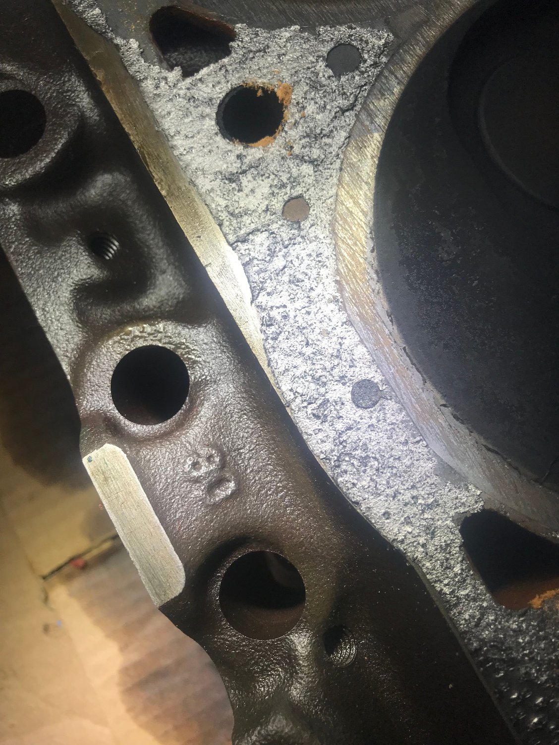

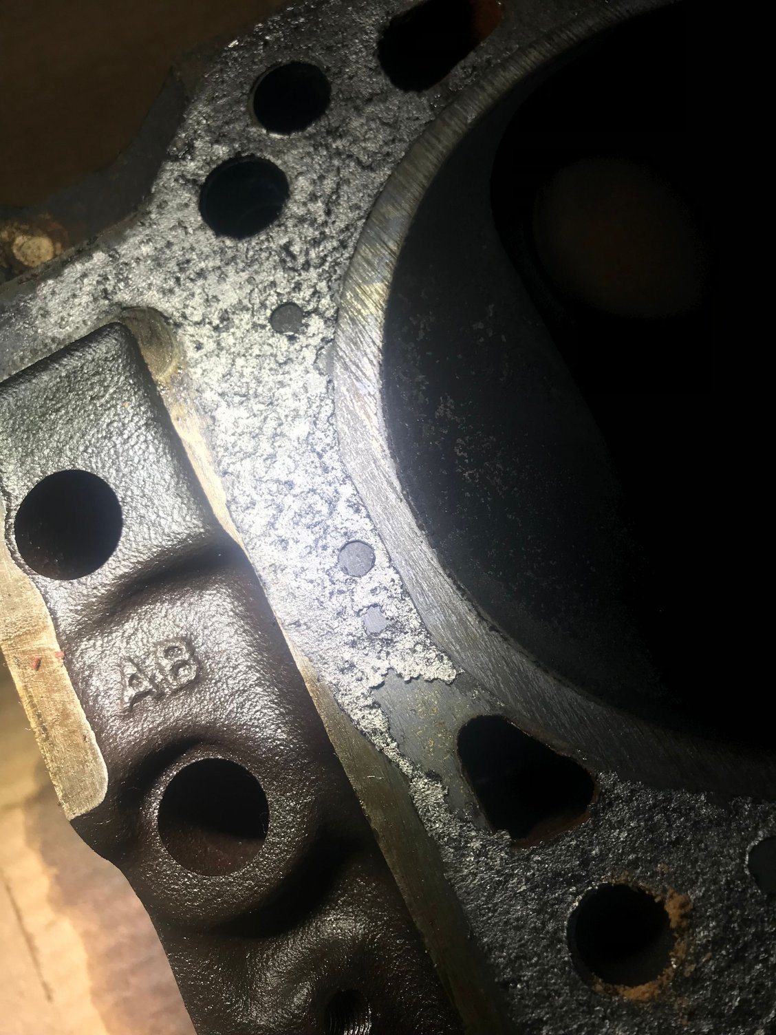

Can’t seem to figure out when the block is from. Has a tag that says “remanufactured.” Pistons indicate it’s bored 060 over, all sorts of weird stuff. Exhaust manifold was off a 79 Ford Mustang 2, but the cab is a 1985 f250, so that’s what it was sold as! Very little money put into project so far, trying to figure out what’s worth spending. Pulled motor out of curioustiy and to change the rear main seal and started discovering all these weird little quirks.

Block casting numbers are on the bottom rear, either above the starter or at the very rear just forward of the bellhousing. If it's an E0AE block, junk it. They were thin to start with and with a 60 overbore, even worse now. My dates were off, assumed that these were E7TE heads.

Well, there ya go.
Found markings for Eoae D30 and then the no. 13.
Drive it till it blows up!

Originally Posted by Bmoodie10
Well, there ya go.
Exactly, it's a turd. Heads are too.

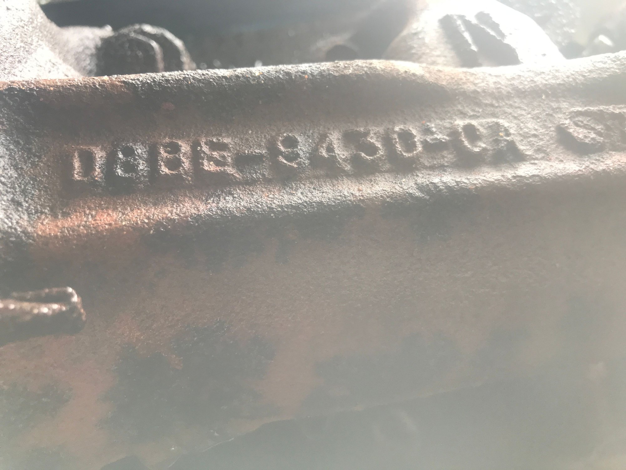

2C2 & 2E4 are casting code dates. 1st digit (2) is the year (1982) / C = March / E = May / 3rd digit is the week: 2nd week & 4th week.
btw: No Mustang II's after 1978, only available 1974/78. 1974's only came with 2.3L 4 banger & 2.8L V6.
must have meant 78. Found these casting numbers on exhaust manifold and they led me toward mustang II.

Third digit being "B" isn't a Mustang part, that would have to have been a "Z" there. Don't recall offhand what that "B" was. Might be Maverick maybe ? Exhaust manifolds were pretty specific to the vehicle it was designed for. But yours being a reman engine, there's no telling.
D8BE-9430-CA = D8BZ-9430-C replaced by D9BZ-9430-E .. 302 Right Exhaust Manifold.
1978/79 Fairmont/Zephyr/Thunderbird/Cougar/LTD II/Ranchero // 1979 LTD/Grand Marquis/Mustang/Capri.
