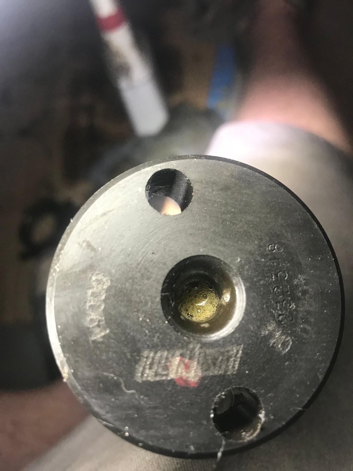

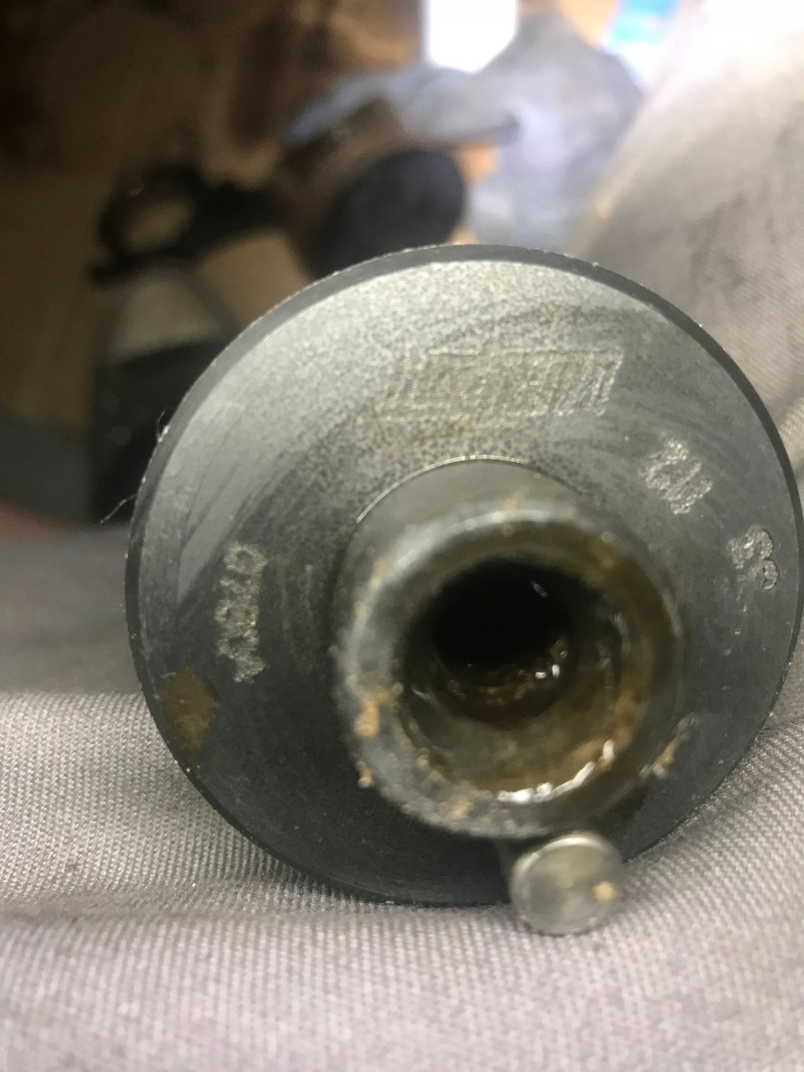

Pulled this evening out of 302. Looks aftermarket. Help???

Lunati something. Flat tappet or roller?

Looks like G7504 ? The 112 I think would be the LSA Probably a roller with that wide an LSA.
flat tappet

There are some video's on youtube showing how you can measure the lift so you can compare. I had to do a lot of research to find my camshaft specs from the same maker. I messaged them twice but never got a single reply.

You can measure the lobe lift using a set of dial calipers. Measure the base circle then full lift then subtract the differences, then multiply by the rocker ratio to get valve lift.
