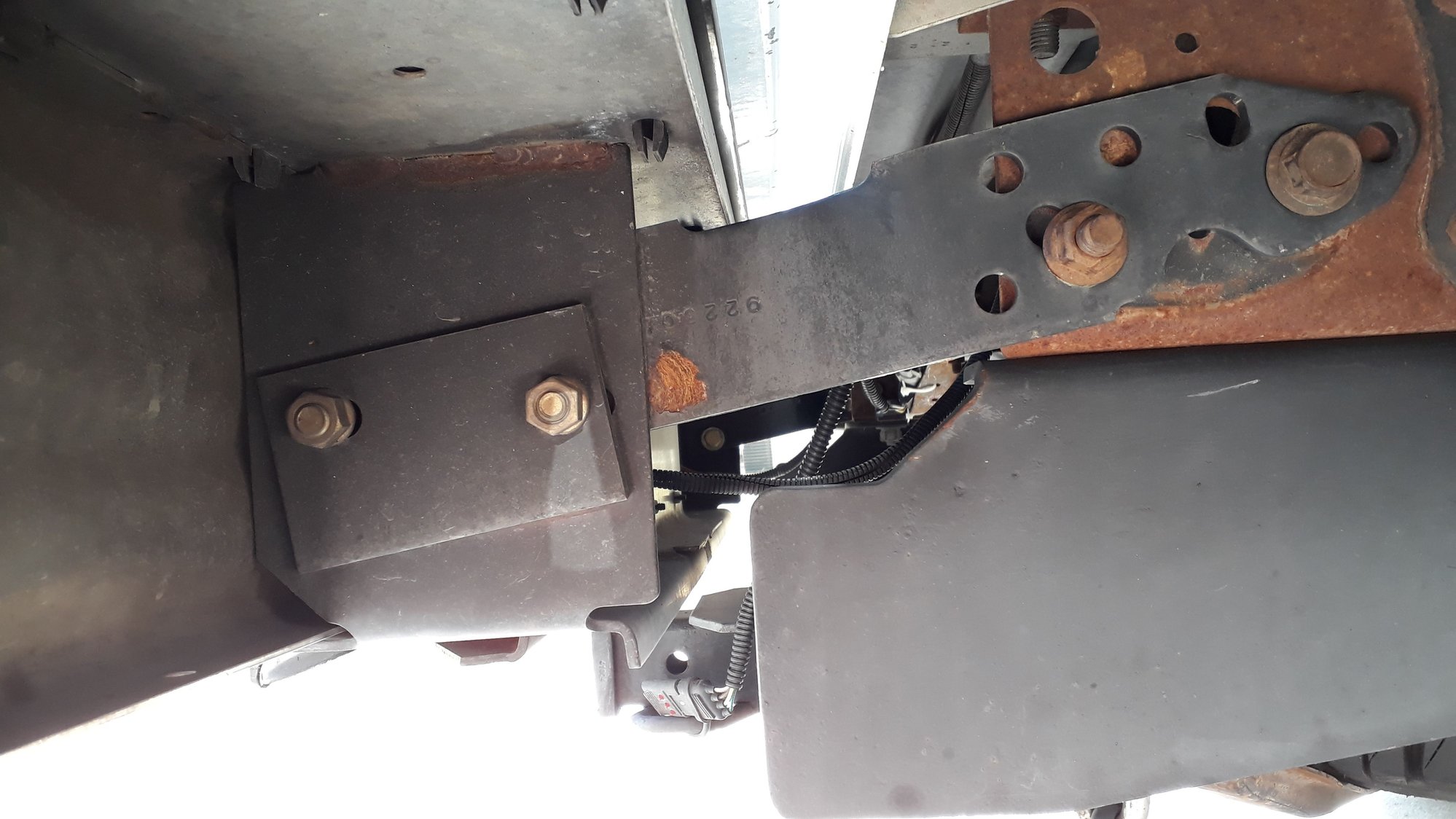

I currently have a Roll-A-Long bumper which the brackets are welded to the frame and hitch, its no problem that I cut them out. My concern is I purchased a new Deluxe XLT bumper Westin/Fey and the correlating brackets part #92230. Per instructions my brackets do not line up as it is in the instruction and i do not want to cut the old ones out if others have had this problem. I can deal with the old bumper then. If anyone that has replaced their bumper with the westin / fey bumpers using the brackets have you encountered this? Or if anyone could post a picture of their bumper brackets mounted I would greatly appreciate this!!! Not sure if it matters but it is a 93 F350 Crew.

I have that bumper on my 94 F150. I don't remember the bracket kit part number though.

TexasGut thank you!!! I saw it would line up with the second hole as you have it, instructions say to use the furthest hole and I was concerned that it would push the bumper against the bed. I appreciate the reply and pics!!

No problem. Hope you can get yours to fit the same way.
