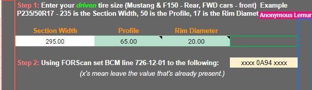

I realize that this is an older thread, but I wasn't able to find a lot of data on this either. I was able to program in a 295/65R20 last night with no CEL as it's only about 3% larger than the largest available stock tire (275/65R20).
I used the Ford As-Built Tire Calculator from the Forscan forum to get the correct edits:
https://docs.google.com/spreadsheets...EqU/edit#gid=0
The code was in the BCM 726-12-01 line and needed to be xxxx 0A94 xxxx. I checked it this morning on my way to work with a speedometer app on my phone and I'm dead on. Hopefully this helps someone as this seems to be a popular size on our trucks.
Last edited by Gasgzlr; Nov 27, 2019 at 12:12 PM. Reason: Add screen shot of tire calculator

This is what doesn't make sense to me...
From above:
Speedometer Recalibration for Different Tire SizeBCM726-12-01xxxx xx00 xxxxxxxx xx4C xxxxForum comment: "Original tire size 275/70r18, New size 285/75r18. No DTC codes after 900 miles. This is a small change. Larger tire size changes do calibrate the speedometer but a check engine light will persist." The following can be used for a slightly larger calibration (ap
Yet if you go to the calculator provided in the above post is tells me it should be 0A80.
I wish I knew what the actual numbers mean so I knew which one was correct...
