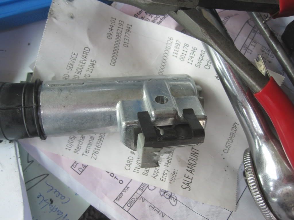

I got rid of the sloppy shifter by replacing a bushing that was no longer there. I'll see if I can find the post I made on it.

that bushing is what goes around the stalk where it goes into the column. On mine, there was no bushing left and that was the cause of my sloppy shifter. Once replaced it fixed my problem.

So, dove under the covers yesterday, looking for where the reddish bushing went. I never found it, nor did I find a listing for it searching Ford and other sites. Already had the tube and inner rod, so decided to keep going. Followed the video, no need to mess with steering wheel, air bags, etc. Loosened nuts holding column, let it hang down, plenty of room. Apparently my slop was from the tube/inner rod piece, as after replacing those and fresh grease shift lever has never been tighter (in the 7 years I have owned it). Nice.
