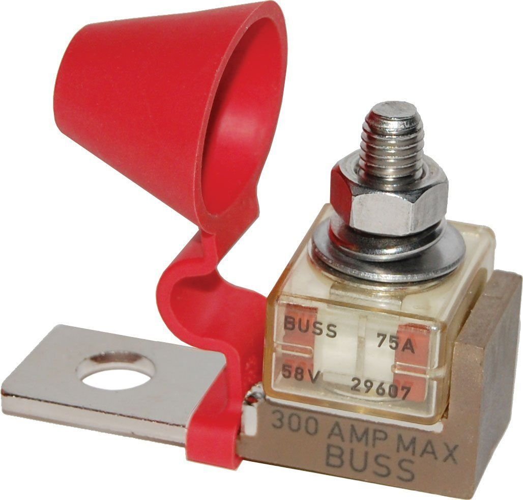

I agree that an isolator robs voltage and a continuous duty solenoid would work. They can be installed anywhere without worry of voltage drop just make sure your 2/0 wire is fuse protected close to the batteries as a rub thru or short would take out your truck. It's hard to fuse a wire that heavy but it must be done. The marine industry does have alot of options you are looking for, they deal with this type of system more than the automotive end does. Hope this helps.

Something like this might suit your needs in the fuse department.
