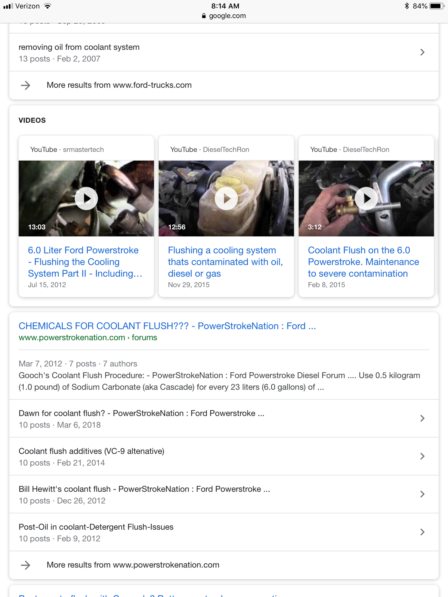

VC-9 is an acidic flush for excessive rust. If you search for any oil in coolant thread on any site you’ll see Ford techs recommending Cascade. Sorry, these guys have no clue.

I got a call back today, they are using a flush that is used for oil, now not the VC-9. I still don't think this is going to fix it. I don't see how that much oil got into my system from residual oil in the oil cooler. I think the tech pinched a seal or something. Too much oil. maybe we'll see tomorrow, they are to flush it then. I heard Cascade isn't that great, because it doesn't foam, getting into nooks and crannies. It only gets rid of what it touches. Doesn't climb up so to speak. I could be wrong. But they said they were picking up some stuff used on big rigs, I'll find out. Thanks

Non-foaming ....... is the idea.
There’s always search.
