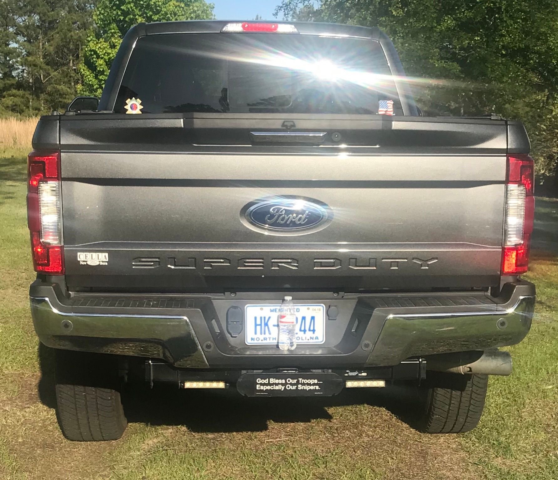

This is what I installed. Really simple/cheap LED's off amazon. I have not used them to back up to a trailer yet, but they throw good light.

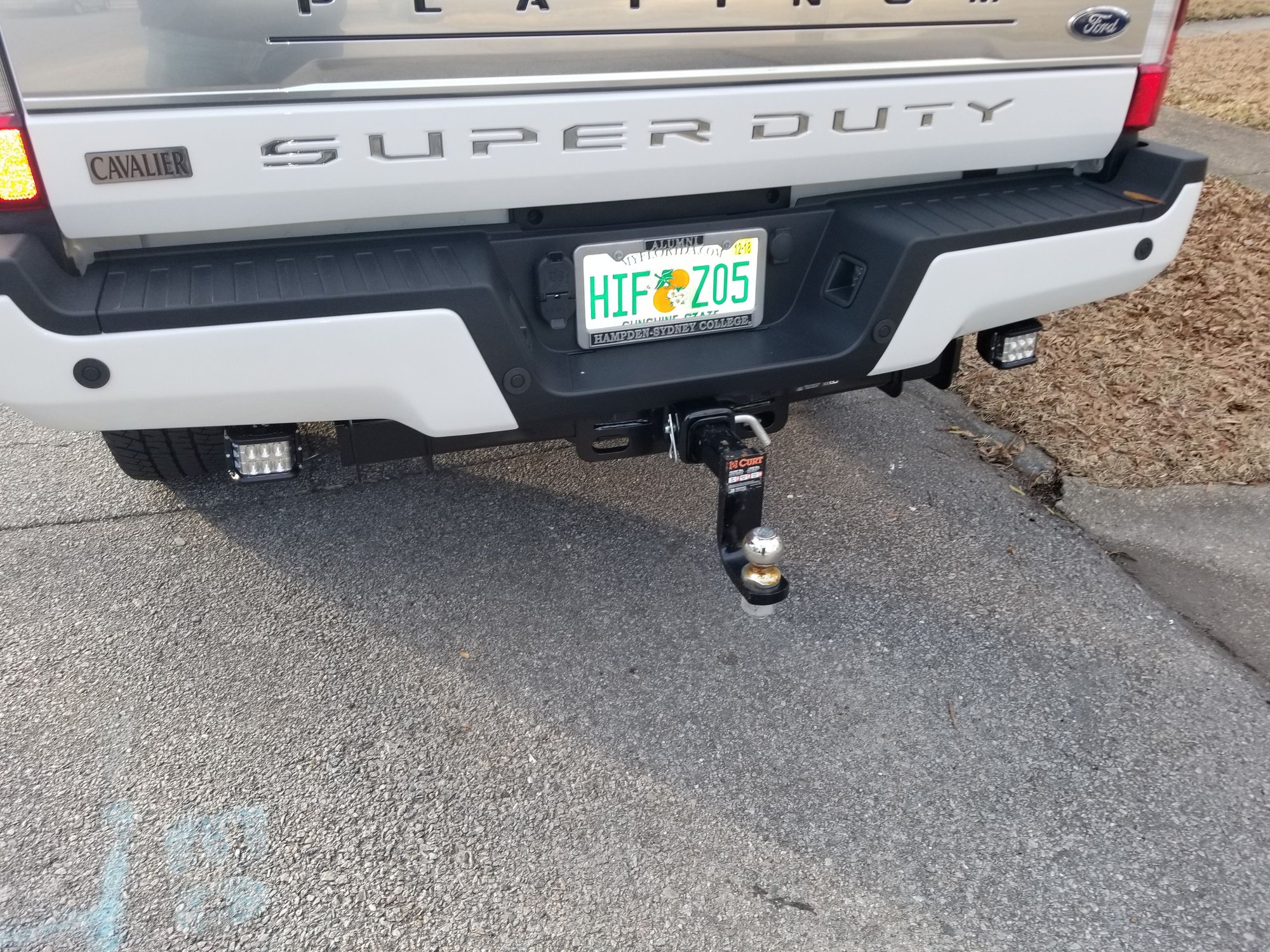

I installed these on my 17 F250 a few months ago - no drilling, just removed factory bolts under the rear bumper and installed. Cut the ends off of a 25' black extension cord to run the wiring into the engine compartment and tap into Upfitter #1.
They're extremely bright and seem to be of outstanding quality for the price.

Thanks for the pics. I like the way the long skinny ones are less noticeable but those cubes throw at a great angle. Very similar to the crazy expensive set I was looking at.

Did you drill into the bumper or was there holes already there? I haven’t looked under there to see about mounting in holes already present.

There's holes and a screw you can use already there.

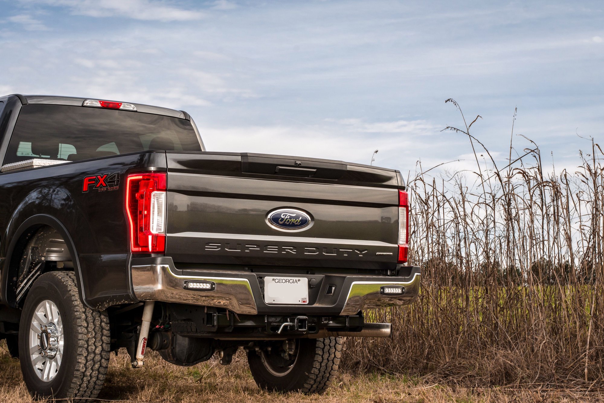

Hella ValueFit flush mount...do not use the screws that come with them though.

this looks great. Idk if I can bring myself to cut the bumper!
