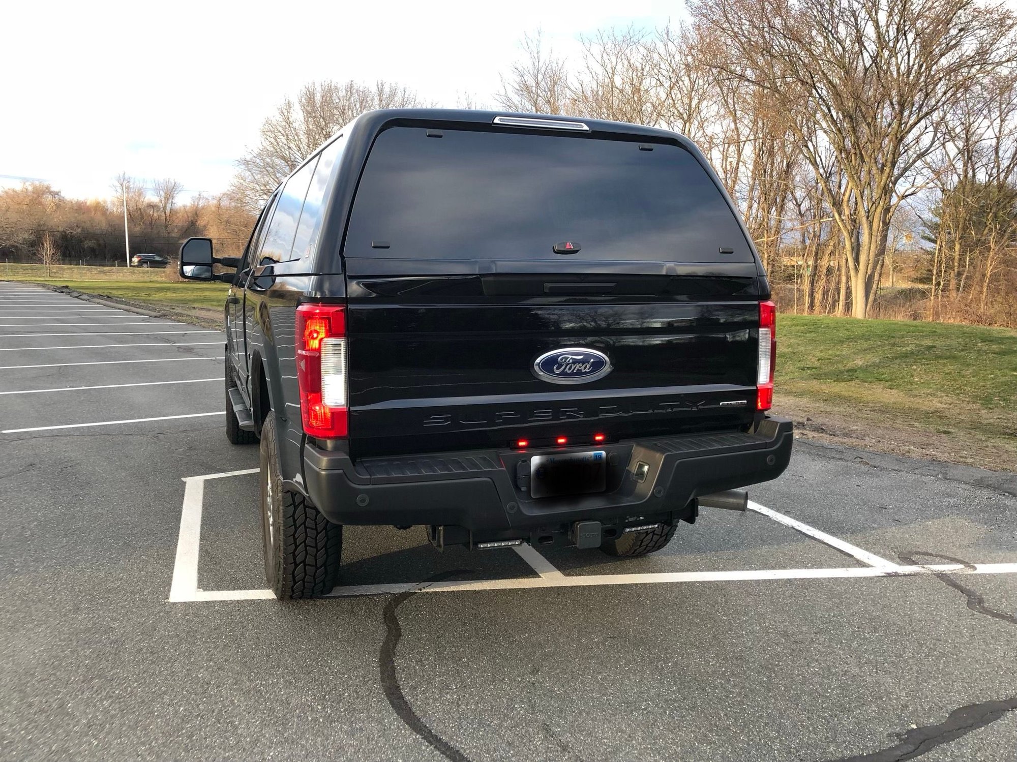

I installed these last week. Wired to upfitter switch so I can use them when needed, not just if in reverse.

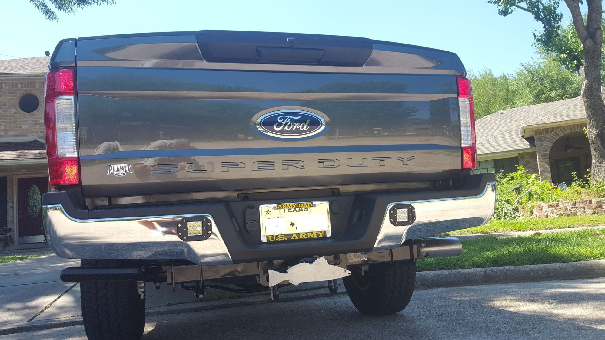

Got these for $26 on Amazon. I cut into my brand new bumper with no regrets. There are take-off bumpers every day for a couple hundred bucks if you absolutely have to go back.
For me, I didn't want anything hanging below the bumper to potentially get ripped off...
Attachment 281983
Those look awful to me. Maybe it’s just the truck they are installed on!?! I joke!!
which brand are those? Is the mounting hardware stainless? I do like the flush mounts. However, I have so much OCD about my vehicles that if I didn’t mount them perfectly in the bumper I would have to just sell the truck!
Haha...it's OK, the Fiat won't be around for much longer!
I'm very OCD as well...but as long as you take good measurements, everything will be even. It only took me 1.5hrs to seal the lights, cut the bumper, and get them mounted.
The mounting hardware is stainless (probably a low grade), but here's a link to them:
Amazon Amazon
The only thing I did was remove the lens and put a bead of silicone around the edge to further weatherproof it. This is a well known "must-do" to cheap LED lights...no matter the brand
