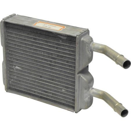

'88 E150 cargo van, EFI six, AOD replaced with C6, 8.8" axle. Evidently there's a small leak in the heater core, because I can smell the coolant, and because the defroster setting is fogging the windshield on cool mornings rather than the opposite (tho' so far I am not seeing any liquid under the heater box. Checking RockAuto, there seem to be two sizes of heater/heater-core. As this was a pretty basic van, and not sold in real cold country, I'm guessing that the heater is the small/standard unit. But is there any way to tell, any measurement, before I order a new core? (Actually, I'll probably look at it first and see if I can solder it).

Here's the two you mention:
high output
E3UZ-18476-B
here is the one called standard or standard high output
Standard high output
E8UZ-18476-A and E9UZ18476B
My 88 E150 with front only heat/as uses the high output one. I think you have to remove the air filter housing to see where the hoses connect to the core. If I remember correctly you can see the difference. I was going to take a small wire or something and stick it in around the tube where they go int the heater core housing and see if I could feel the back of the heater core or not. The one with the longer tubes, you wouldn't feel the heater core where the tubes connect.

I had to go before I cold finish the last post.. It is pretty simply to remove the cover from inside the van and actually.y look and see which heater core you have.
Here is the instructions for our 88 vans..
https://www.ford-trucks.com/forums/1...l#post17926926
