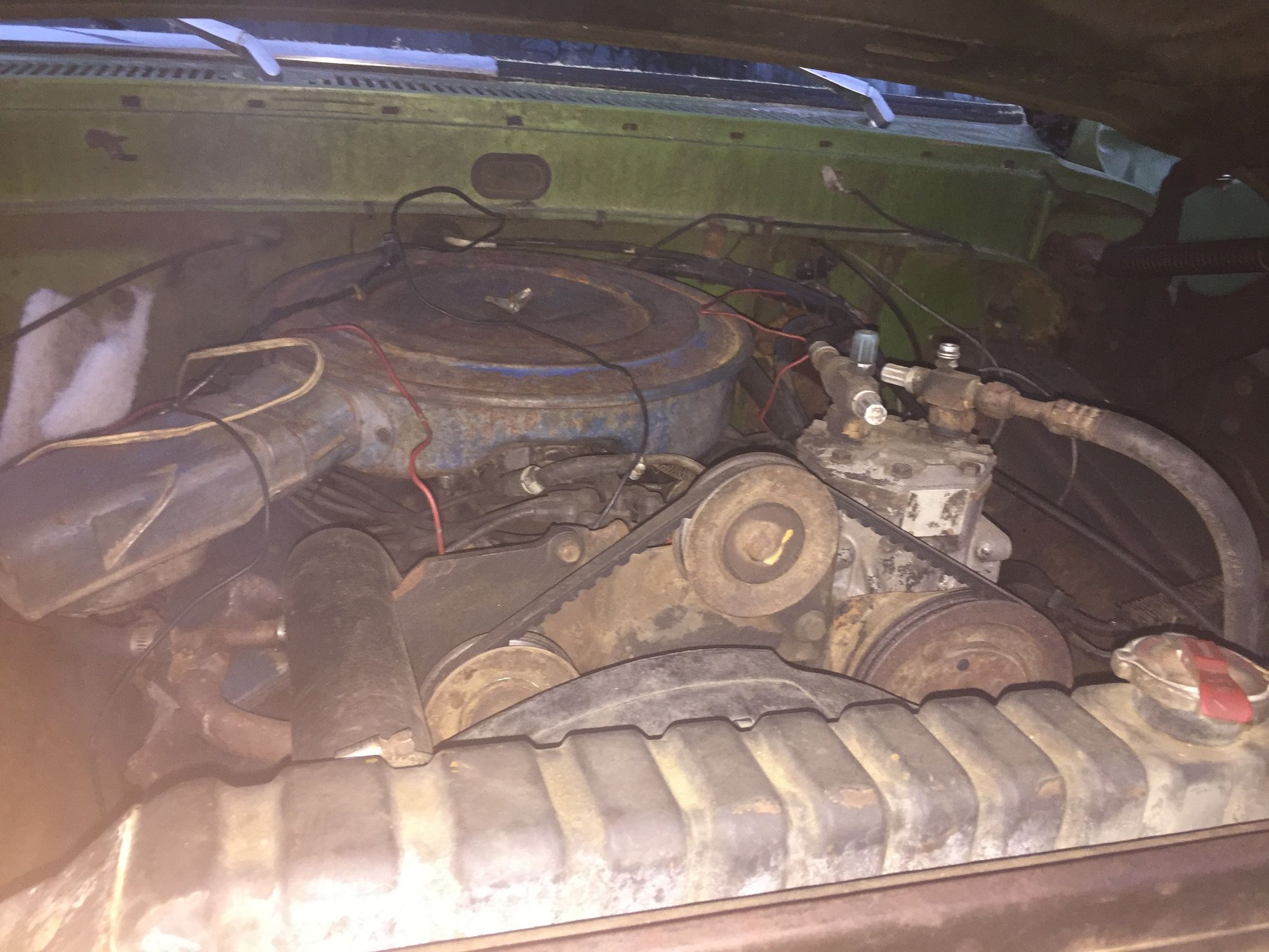

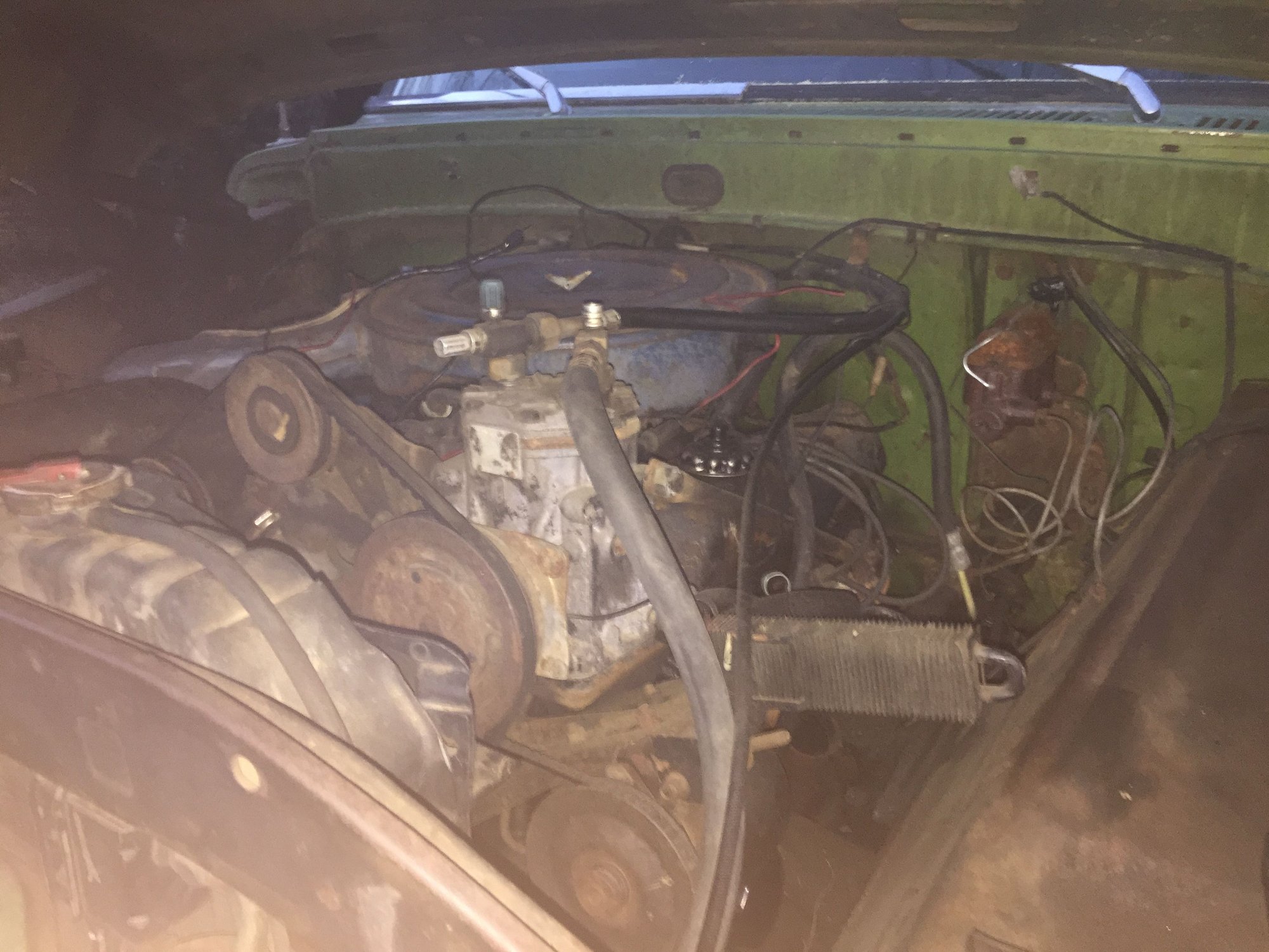

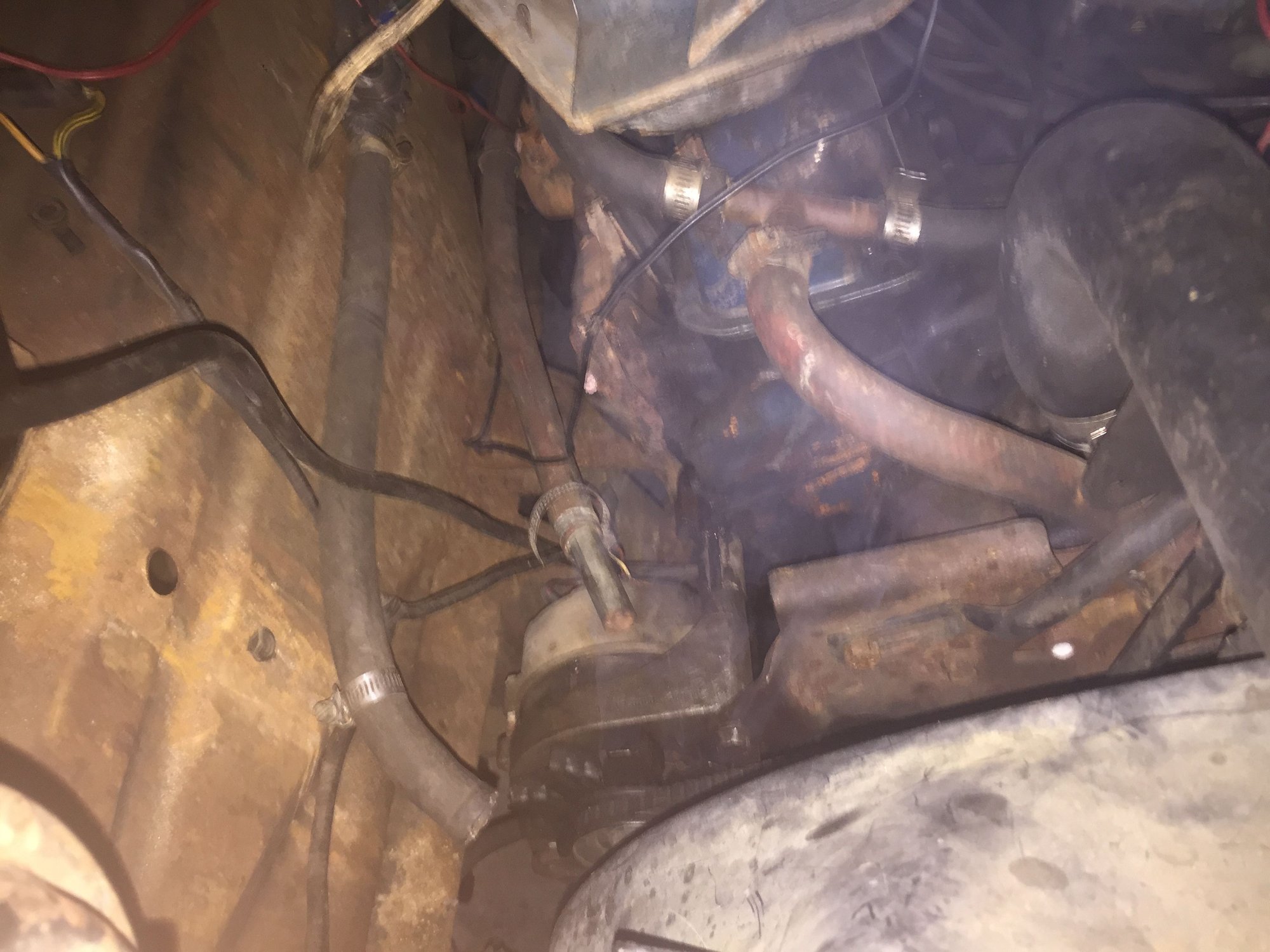

Happy new years, havent be on for some time but could really use help on my alternator. I’ve a FE 390 H code from a 1972 F-100.
Is there anyway to loosen the belt? If so where exactly. I got the short bottom bolt out but the top bolt

You need to get the top bolt loose.

The alternator pivots on the lager long bolt that you missed in your thought processing of loosing it.
That you've learned the small bolt is basely that locks the belt adjustment in to place until the pivot bolt can be torqued to specs.
Ps be careful not to over tighten the small bolt as it can strip the threads out.

Is your Belt upside down ? the cogs (grooves) normally face the groove in pulleys
no they’re on the right way
Edit: but I’ll double check to make sure.

WD-40 doesn’t work any ideas?
If you take the lower bolt off the bracket then try rotating the whole alternator a little. Most likely the aluminum spacer between the alternator and the block has seized on to the bolt. It will require lube, some choice words of your pleasure, maybe some sweat and time to get it loose. If you can get it freed up take the bolt and wire brush the pants off it and coat it with some anti-seize before putting it back together.

That belt is on correctly. I have seen in the past one of the aftermarket belt companies made a series of belts where the outside was cogged like that. I wanna say Gates. I dunno why they did.
On the bolt, clean all that grease and gunk out of the split in the alternator spacer. Then spray a penetrant of your choice there. Using the split to get the penetrant straight to the bolt. Like PB Blaster or a 50/50 mixture of Acetone and ATF. The latter being better.
