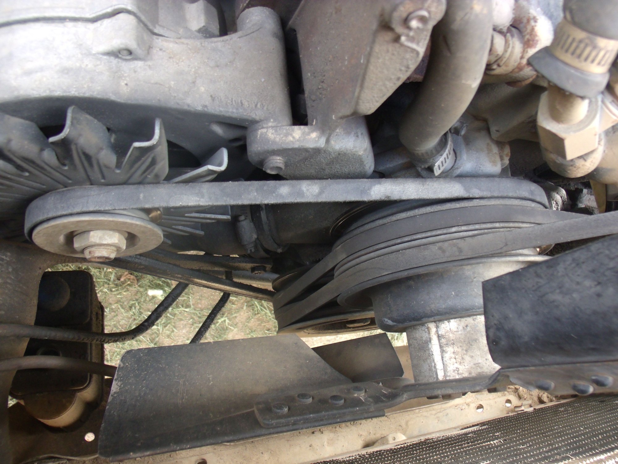

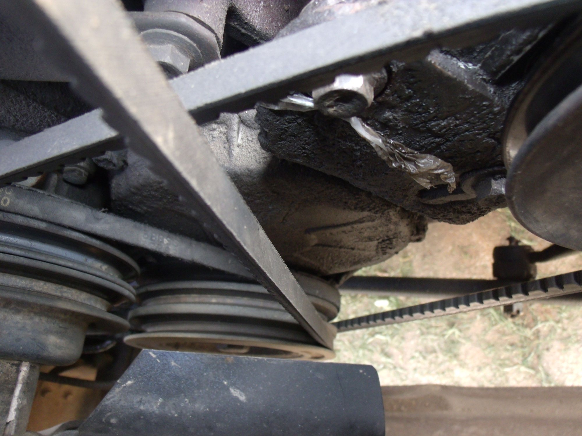

I hope someone can help me. I've got a 1981 f150 I6. I need help with changing the belts. Here's the thing. I don't know where to start. I've been waiting for 9 months for a certain someone to do it and I am thru waiting. So...here I go. I know all the basics. I need to know what to loosen to get the belts off. The alt? The...?? There are 3 of them. And one of them is a lawnmower belt. It came like that. (IDK) Anyway..I'll try and post pics. Hope it helps. thanks for any help you can give.

Looks like alternator, a/c compressor, and power steering pump.

For the belt closest to the engine you will have to loosen the alternator. It pivots on the bolt up high, the head of the bolt is behind the alternator area, you can see the other end threads sticking out in the picture below. So you just loosen the pivot bolt, and then look down low underneath, there should be a bolt in a slot.

The next belt moving forward would be for the power steering. You need to loosen the power steering pump for that belt. It will have a pivot bolt like the alternator, and you have a shot of the slotted bolt in the picture below.

The last belt closest to the fan will be for the A/C. I don't see a good picture of that, but it is the same formula, probably a pivot bolt it swings on and a slotted bolt somewhere else. Don't worry about it, we all struggle and fiddle with this stuff till it finally moves. And you will find this is the time where the government started making them switch over to metric. So some bolts will be metric, some are still American. Usually anything that screws into the engine will be American, anything that screws into a add-on bracket will be metric.
