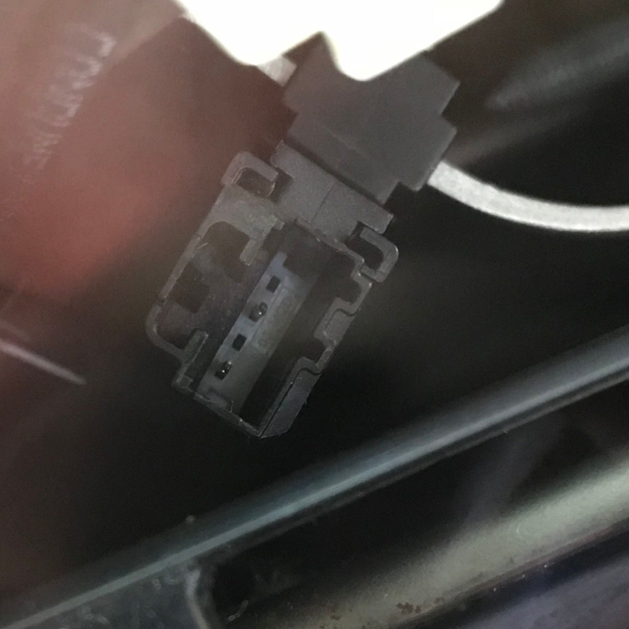

For reference this is an empty shot of the plug for the recon harness or where wpt-982 would go into. It looks like the two bare wires from the recon harness would need to wire into the 1 and 3 hole. I am no electrician so I could be wrong

Well I am 1/4 of the way there. For anyone that may ever get in my situation that orders a recon harness with bare wires, wpt-982 is the connector you need. When wiring connect the red harness wire to the far left (#1) green plug wire and the black harness wire to the 3rd position green plug wire. Sorry for the crude terminology. I’m not an electrician but hope this helps someone
