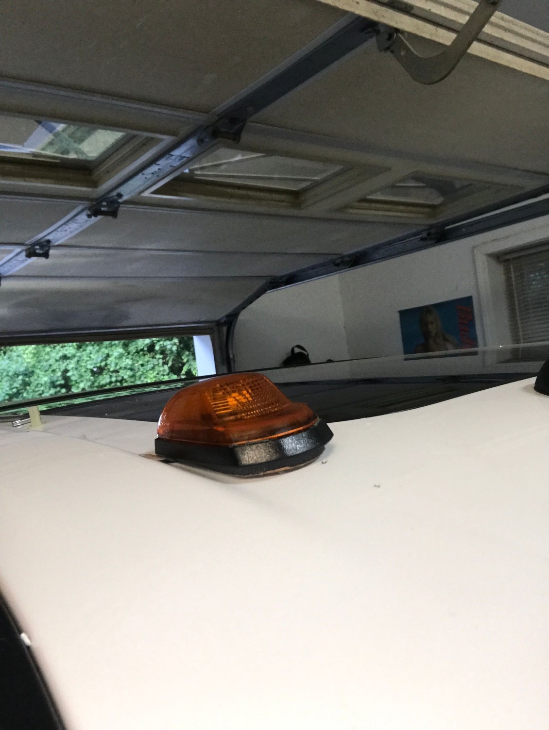

So I ran into a slight issue and now I’m at the point that I have to make a decision one way or the other and hoping for some input.
I went to install the first light and when I got it in place, the plastic wasn’t flush with my roof. My immediate thought was the gasket wasn’t going to compress enough, even with the screw in place (because it’s at the back of the light and I still would’ve had a lip at the front). Making a rushed decision, I peeled the gasket off and went to reinstall, but it still wouldn’t sit flush. My thought is now that maybe the screw would’ve pulled it down all the way. my 2 questions for the board:
-when the screw is installed, is it going to pull the light down on all sides so it sits flush and there is no lip?
-now that I have 2 lights without a gasket and the rest with them still on, do I just install like this and silicone the crap out of them or bite the bullet, order 2 new lights, and delay finishing the project?

Here is one of the lights test fitted with the back screwed down. I can’t get the front to flatten down the back is sitting flush because it’s screwed down

Just my opinion. But I think you’re going to have a little gap. Someone with stock lights may have a better answer but I know none of mine sit flush, plastic to metal.

Update: There was a square tab to the right of the plug on the light. I cut that tab off and they now sit flush. No clue why on earth that tab is there, but since I have oem lights and the factory notches out the roof on the right of the rectangle, I’m assuming the recon lights don’t include the tab which is why a square hole works for recon
