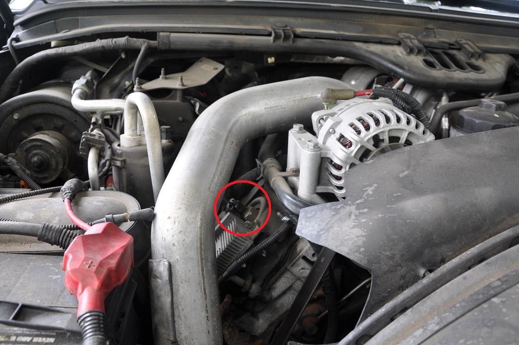

From: Breckenridge, TX

Originally Posted by texastech_diesel
Dumb question, but is this positional related? That's why I think I have a rail plug problem; nose up doesn't end up with a long crank for me, just when it's parked flat.
Have you tried pulling the ICP to check oil level in the rail after sitting overnight on flat ground?
Old May 2, 2018 | 10:36 AM
  #40
navistarnut's Avatar
navistarnut
Joined: Aug 2015
Posts: 3,910
Likes: 18
From: NW IA
Originally Posted by Yoteman
Thanks for all the help guys. I’m really not sure what to do now. Weird thing is, it’s started perfectly yesterday and today. Very odd!
Just for kicks pull the ICP sensor plug off and make sure it's not oily, the sensor female end should be dry as well.
do I need to order a special tool for that?
Old May 2, 2018 | 12:36 PM
  #42
navistarnut
Joined: Aug 2015
Posts: 3,910
Likes: 18
From: NW IA
No sir, just pull the plug off the sensor. It's on the passenger side valve cover right next to the glow plug module.
Lucky for you the truck is an 04 in this instance, on the 03 the sensor sits under the turbo

I thought read earlier where he has an early 04??? Could be wrong though.
Old May 2, 2018 | 03:18 PM
  #44
Tideman's Avatar
Tideman
Joined: Nov 2008
Posts: 1,443
Likes: 9
From: South Alabama
Don’t lose the little white plastic “basket” that sits inside the plug. That causes odd problems. I’m with bismic, I’ve not seen you state year model truck.
Sorry I see 1st post says 04. Missed it.
Old May 2, 2018 | 03:35 PM
  #45
navistarnut
Joined: Aug 2015
Posts: 3,910
Likes: 18
From: NW IA
Shoot, if that is the case then my bad. I though it depended only the MY. I was going according to the 2004 coffee book and memory.
Note to self, never assume !@#$ when dealing with an 04. Ridiculous.
