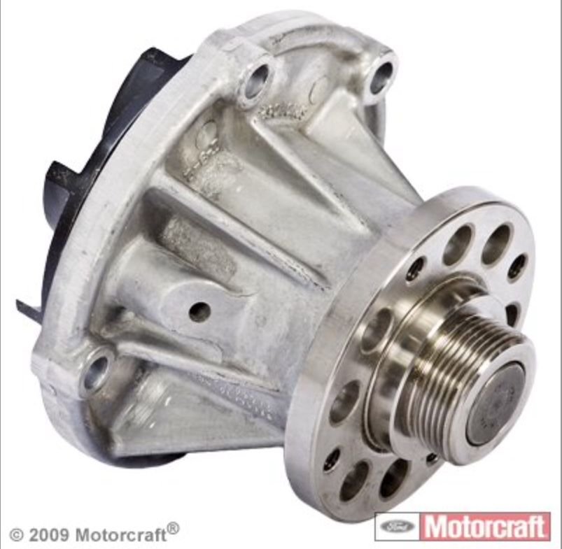

Mark (Bismic), do you have any info in your records if Airtex continued to be the supplier of the water pump in the 6.0L?
Airtex is around $50 while Motorcraft is around $125 for the 100mm pumps, no core with either.
From my looking around at different sites, if you have a remaned motor and not sure what waterpump/front cover you have and don’t have the front cover casting numbers to sort out, at least on the Airtex/Motorcraft pumps the 90mm pump has only four threaded holes in the pulley flange. The 100mm pump has the four threaded holes and four lightening holes. That may hold true on the aftermarket suppliers that private label their stock from the source.
