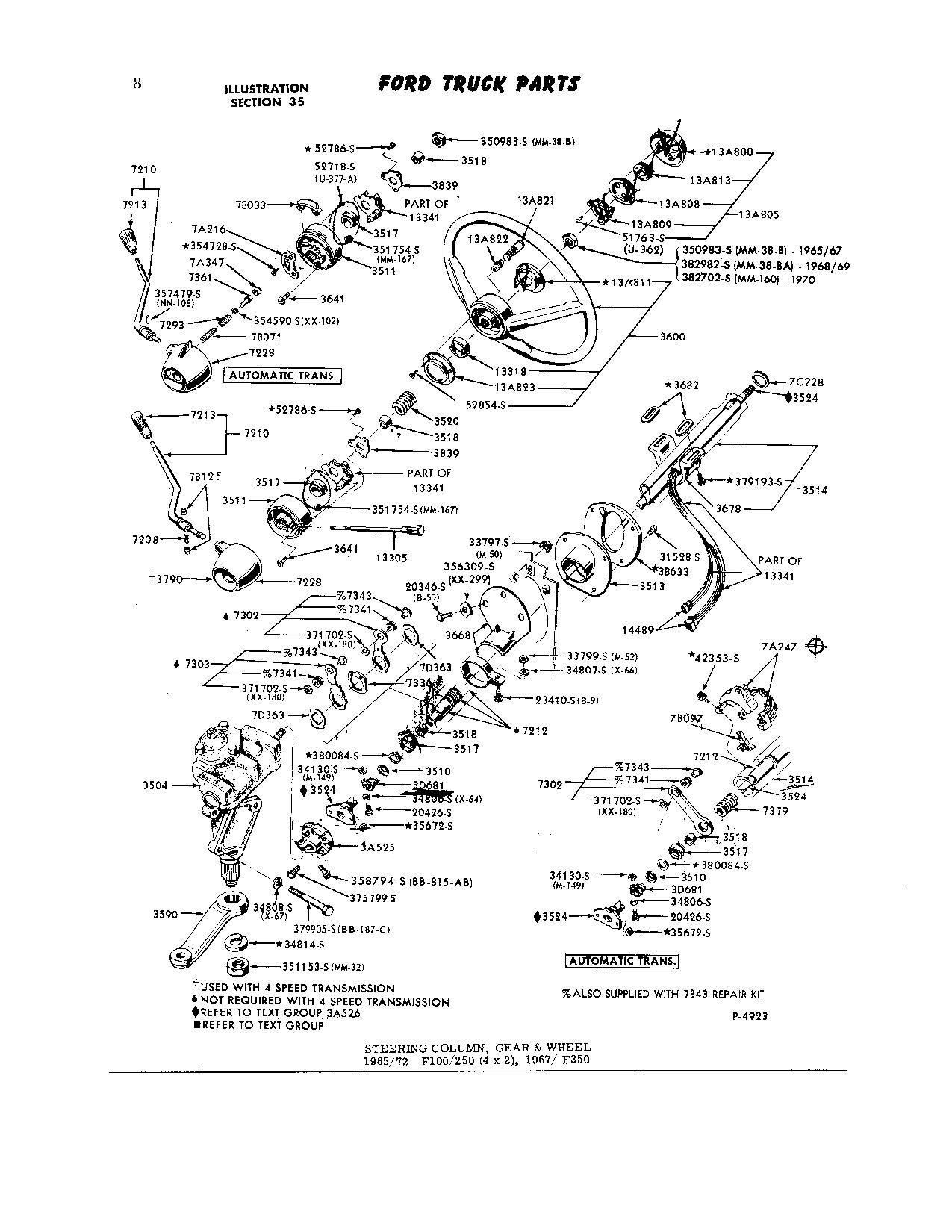

I am doing a resto-mod on a 1972 F100 and self developed a problem. I pulled the actuation pointer for the neutral safety switch switch off the column by accident and have tried for several hours to reinstall it without pullling and dismantling the steering column. Does anyone know of a special tool, trick, or any other method of replacing this without tearing everything apart. I am a novice at this and would appreciate any advice I can get.

It can be a real b!tch to install the NSS selector lever and there's only one way to do it. Usually by laying on your back trying to attach it to the shift tube thru the hole in the steering column shroud.

It is no fun but possible. Take your phone or whatever and take some pics inside hole in the column so you have an idea of what's inside. Look at the scratches from attempted installation. You may need to bend the piece a bit.
I think I had to unbolt and rotate the column (in place, with everything still hooked up) so I could see what I was doing better.

Pic of the little darlin' shown at lower right, see 7B097:
