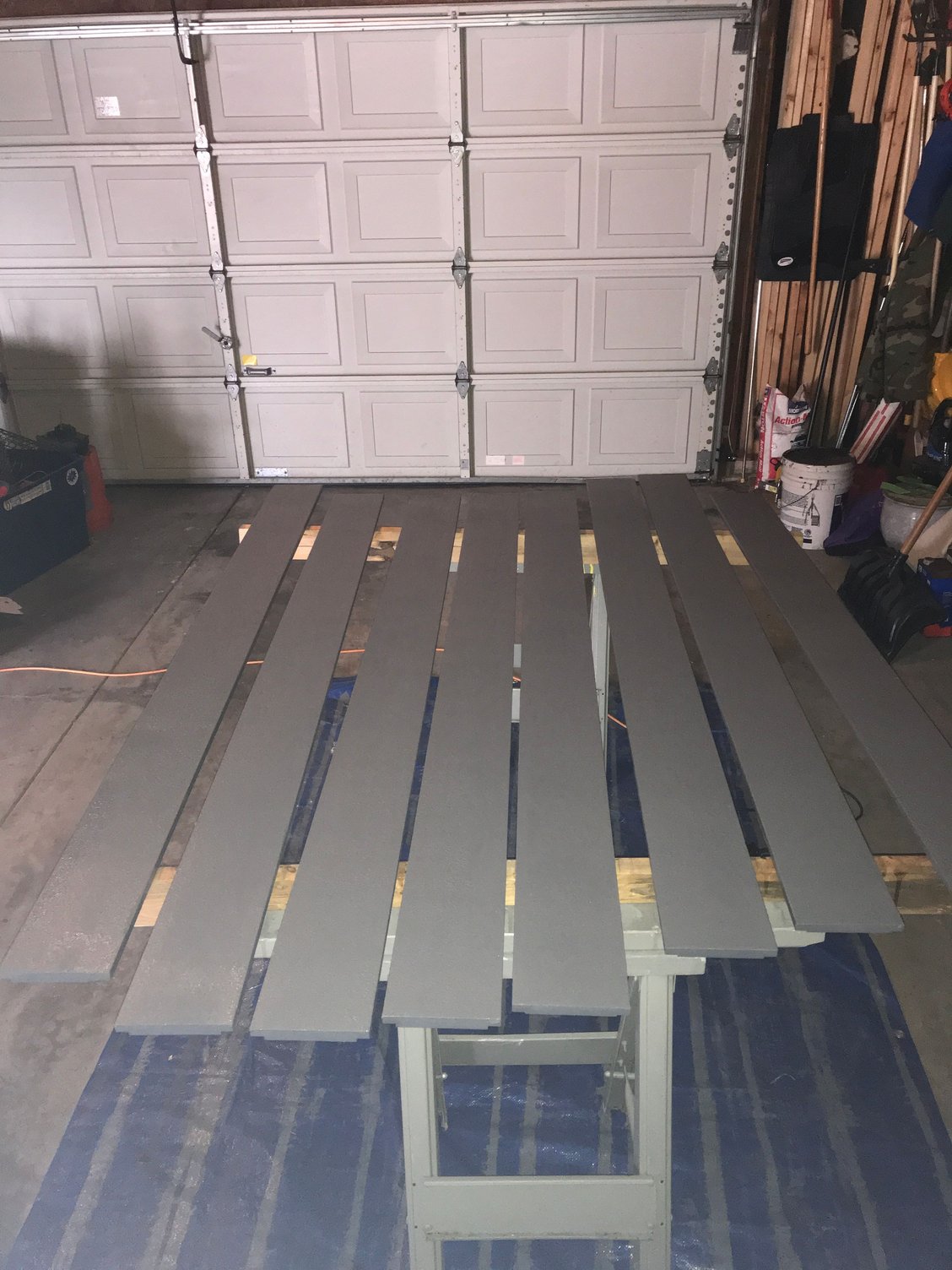

I would like to do one of my F100s bed in IPE. Some of the flatbed semis had it and it wore like nails and had no maintenance. Unfortunately, my bed (from Midwest Early Ford) came as a kit with red oak.

I decided to use this from Home Depot. Sure glad I didn’t get the textured
DeckOver smooth under $45 at Home Depot
1st of two required coats.
