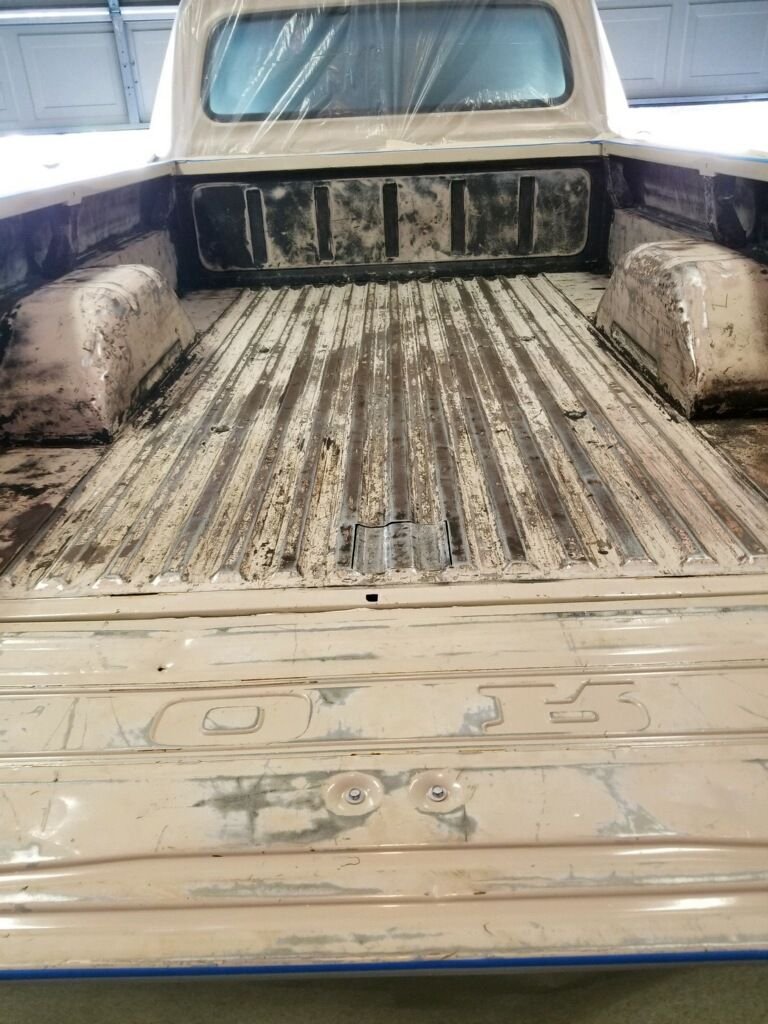

I had some left over Raptor bed liner from my wifes El camino project so I decided to sand and redo the Bed of Pebbles . I didn't fix any dents as there was more dents than not .
I sprayed some Kirker Epoxy primer down first to seal any bare metal.
Here's the pics

Raptor is a 2 part urethane bed liner , it's great stuff . I used 1 kit for bed (4 bottles)
It sprays with a body shutz style gun that screws to the bottles . it's very easy to spray . I reduced the liner with 2oz of urethane reducer in each bottle to get a smaller texture .
here's some while sanding pics .
