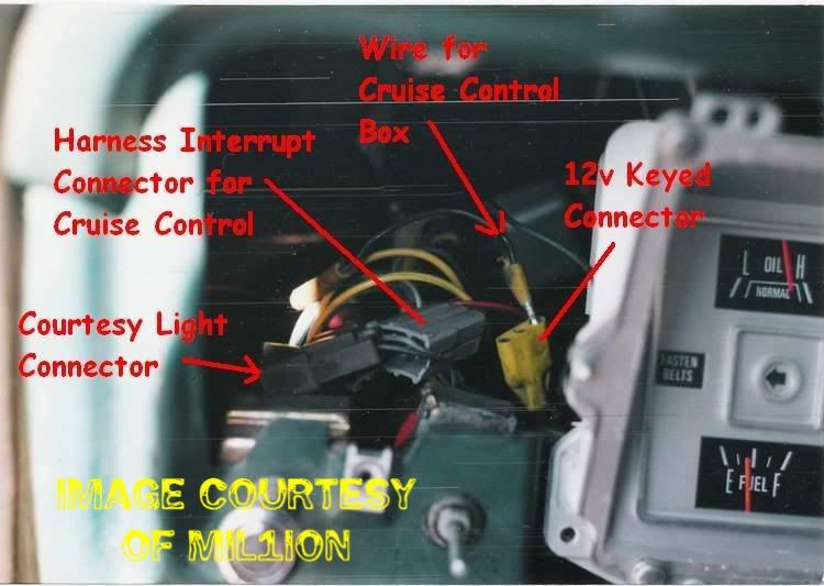

Pic is for a reference in what the plug looks like. That harness plugs in to a 12v (hot all the time) 3 hole (black color?) plug sort of behind and a touch left of the glove box. One male end in the 3 hole plug, (short wire) gets plugged into the glove box (on when opened) spring loaded light assembly. Other end (female) goes to the stud on the back of the lighter. Grounding of lighter is being installed in the dash.
If you can not spot the plug from under the dash, take the glove box liner out, to easy find it.

Here is what the other 3 hole plug looks like.

My truck has a single bullet jack with constant 12V+ behind the dash, which hangs over the ashtray, but will not reach the little lug on the lighter outlet/jack a few inches below. I thought that was what Ford used for lighters. I have my radio's yellow Constant Power lead shoved into it.
You can see it in this post, and in other illustrations and pictures:
https://www.ford-trucks.com/forums/1...l#post14696841

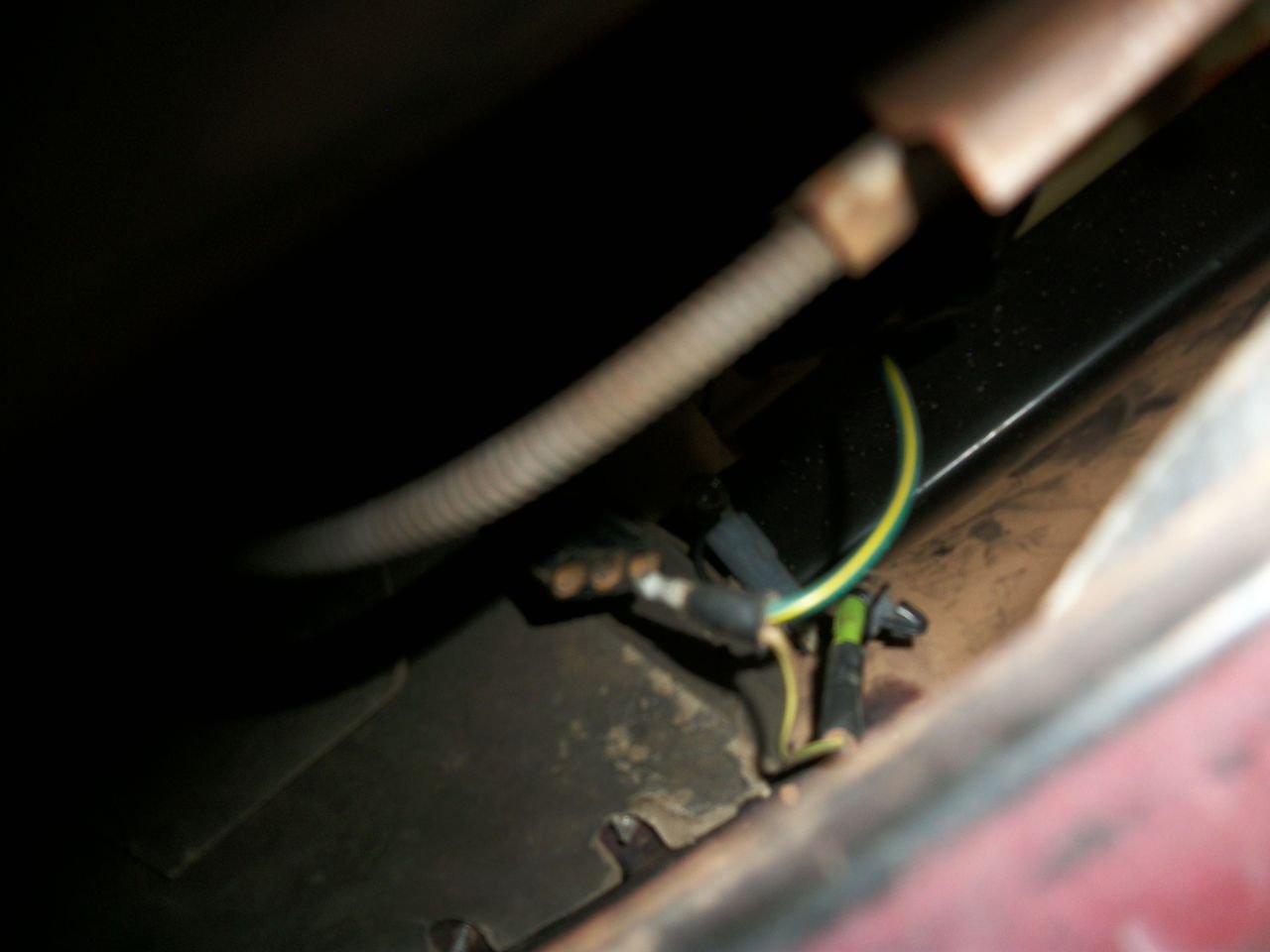

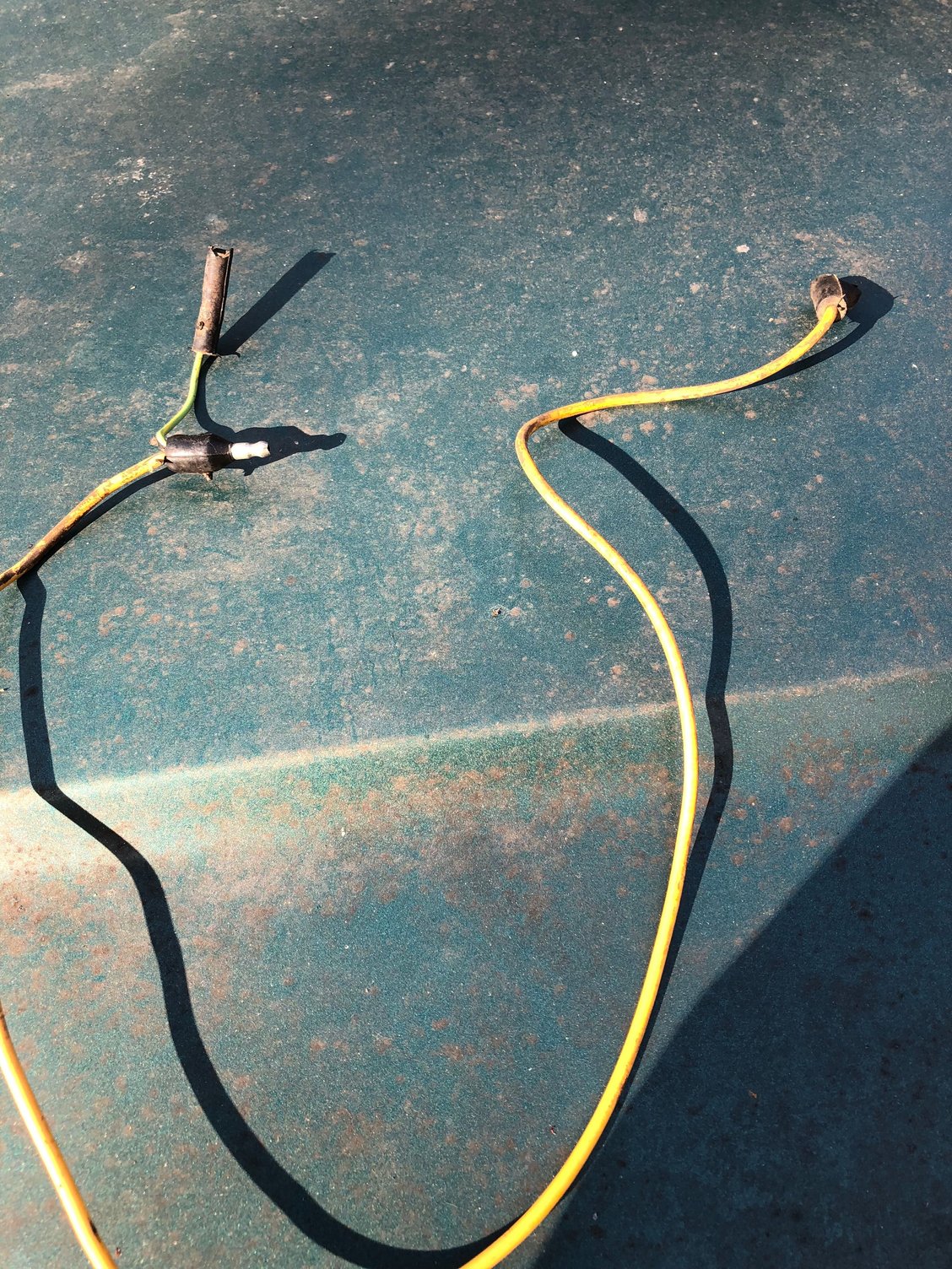

Hey 77&79F250, Don't know if you can do it or not but maybe add these two pictures to your save file some where or in the technical links? Your pictures have helped me a ton as well so maybe these can help someone as well?
That 3 prong plug you show in your picture over by the glove box. One truck I stripped for parts had that plug. I still have the old wiring harness but my '77 F350 Camper Special which has the XLT trim and my '77 F150 4x4 both have this style plug over by the glove box. The first picture below has two wires into a single plug. Wires are like a light greenish in color. The heavier gauge green with yellow stripe wire goes to the lighter. Then there is the open plug smaller gauge wire that feeds my glove box light.
