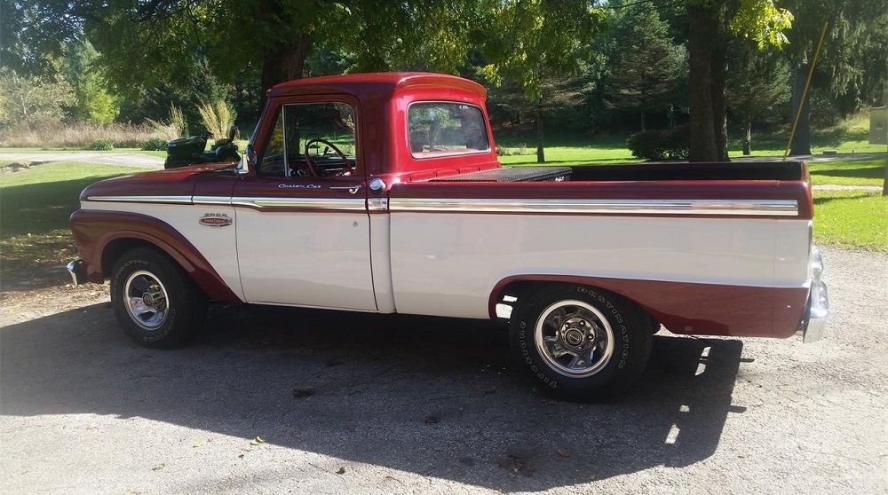

From the sound of the post on the HP, this baby is dead stock except for the newer wheels... Does it look right to everyone? Regardless, I don't think I'd change a thing, More pics here.

From the sound of the post on the HP, this baby is dead stock except for the newer wheels. Does it look right to everyone? No! Regardless, I don't think I'd change a thing, More pics here.
This shade of red paint is in-correct and the tu-tone paint scheme is wrong, as is the seat upholstery and the horn ring. The fuel cap was painted body color originally. The sweep speedo cluster has been painted.
The Custom Cab stainless steel windshield reveal mouldings are missing. The P/B booster and dual master cylinder certainly aren't "stock." The air cleaner is from a car.
Tailgate handle painted, cab quarter mouldings appear to be attached with screws, grille not highlighted with black paint, ditto upper grille panel.
Cannot see the right side of the dash, so don't know if the radio and/or the A/C is original or not.
Door access covers have radio speakers mounted to them.

Something's wrong with the bedside trim molding. The rear end of it should not be square. Originals had an angled end.

Personally I don't like the paint scheme. Nice truck otherwise.

Why would it have 2 brake light switches?

If I was going to do a frameoff restoration I would do a lot better job than that truck has had. Looks like they used heavy amounts of undercoating underneath and under the hood. To hide what. Undercoating is even oversprayed on the firewall above the cowl seam. You can see 4 spots of daylight thru the box. Don't think it is as nice as it appears. I also agree about the paint scheme. OOPS I just reread and it was a frame on restoration. Now I am sure there is a lot of hidden things.

I agree with that. Also, the original post said it's original except for the wheels and asked what people thought about it. So, I'd expect guys to start pointing out all of the non original things on the truck.
If an owner of a truck posts some pictures and says what do you think of my truck and the mods I made he'd get a different response.

If the word "restoration" can be used with any mention of this truck I have some Ocean Front Property for sale in South Dakota. One of the biggest slop jobs I have seen. It would be more difficult finding something "Correct" than what is wrong with it. Looks like they are trying to turn a 25k profit looking at price wanted.
Yikes, I didn't notice that...
