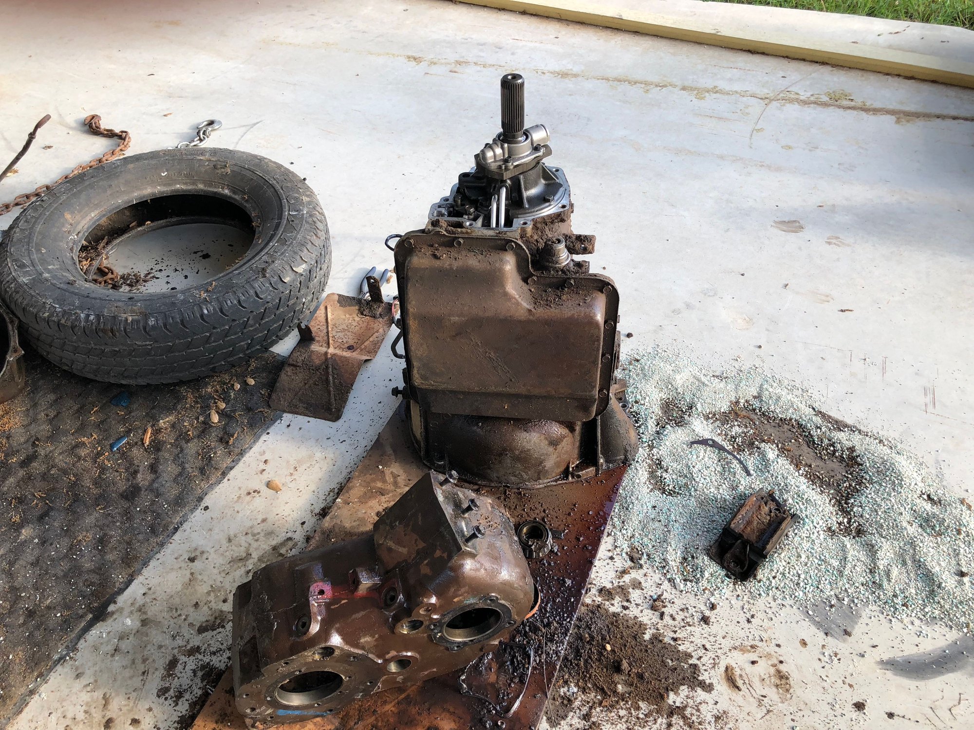

Ok, I figured out how to upload photos. I wish I had taken more of the drivetrain on this truck. I've never seen so much grease and dirt that just didn't want to come off. The zero point on the pressure washer wouldn't even cut through some of it.
