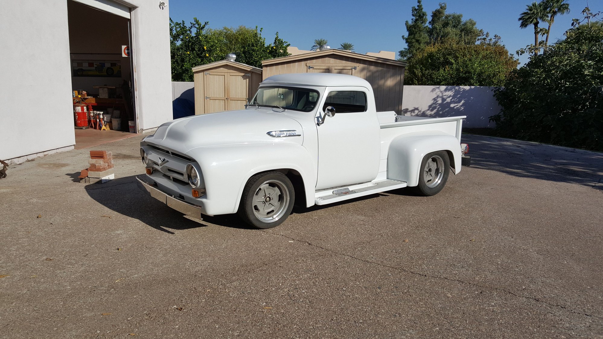

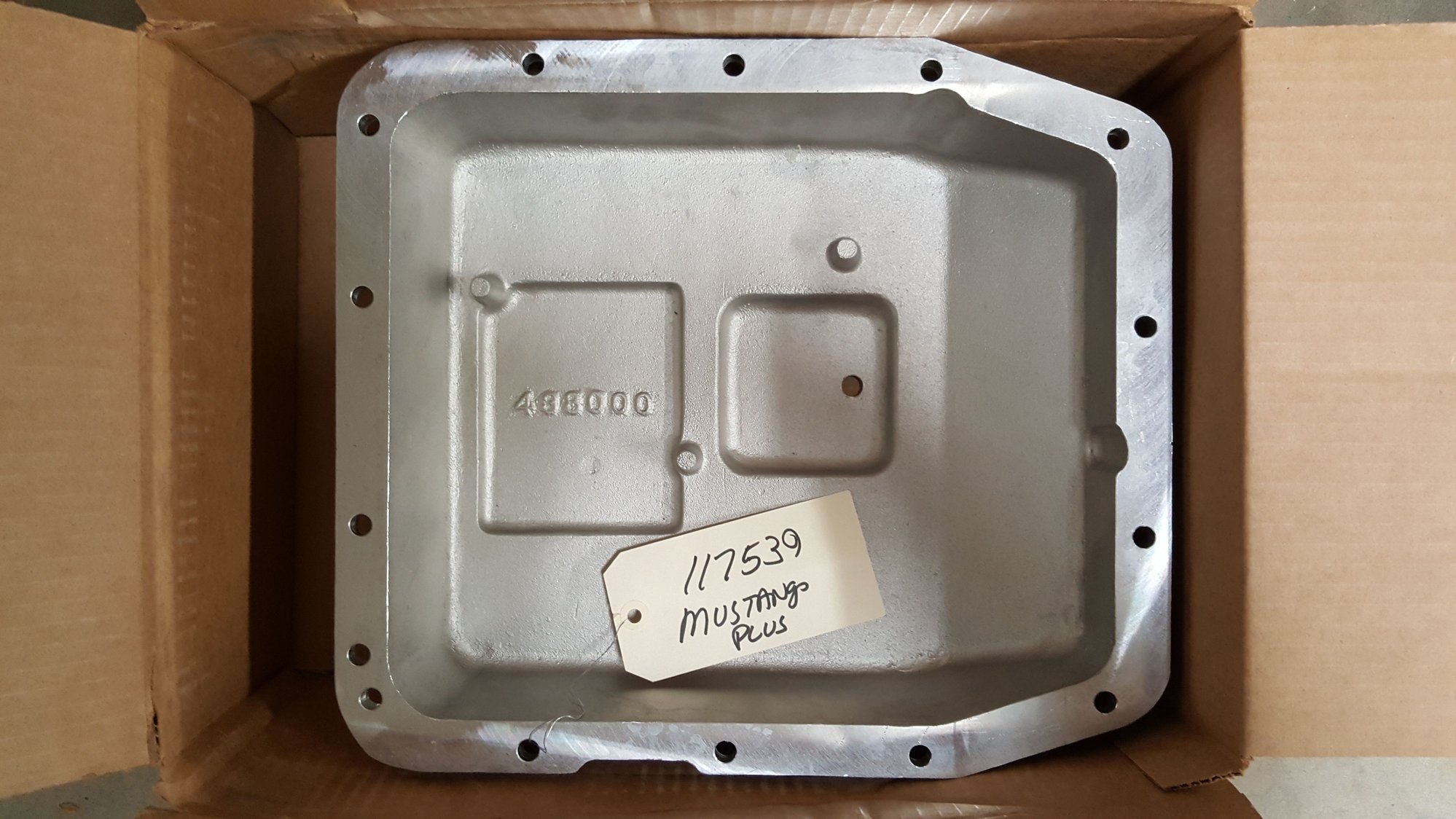

I need some insight on a weird issue. I am selling a 1953 F-100 hotrod for a friend and am in the final stages of getting it ready. This truck is beautiful and has less than 45 hours running time since the re-build. One of the final pieces was to replace the oil pan on the AOD transmission with a cast-aluminum deep sump pan. I removed the existing pan and replaced it with the cast-aluminum pan. From all of the information I could find, the old pan held 6.5 quarts of fluid. The new pan increases the capacity by 2 quarts, so I replaced 8.5 quarts of fluid using Mercon-V ATF. Once complete I took it for a test drive and it would not shift into second until the engine warmed up. Once warm it would shift 1-2 but no further. No 3rd or overdrive! I am baffled. On the freeway in D position, it will eventually free-wheel like it is in neutral. I visited a transmission shop yesterday for diagnosis and was told that the tranny is likely toast! Ok, here's the $64,000 dollar question: what did I do to cause this? The lady that owns the truck (her deceased husband built it) wants to know how a brand-new transmission could go bad!!! Did I cause this? If so, I'll fix it. I asked the owner of the tranny shop and he said it was just a bad coincidence that it happened on my watch.
Some other background is the lady's son drove the truck a few weeks ago and brought it back saying that one of the brakes was dragging. Huh? 4-wheel discs (Baer) that are also new never had a dragging problem when ever I drove it before. Also, I noticed that the retro-Cadillac air cleaner stud was broken off and the air cleaner was not secured to the Fuel Injection (carburetor-like) air handler. It also needed a front-end alignment. Is this a tell-tale that the son did a boo-boo? I am looking for answers here so I can help this lady through this issue.

Silly question maybe, but did you replace the pickup tube with one that would draw from the deeper pan?
Old Apr 13, 2018 | 06:05 PM
cyoung311's Avatar
cyoung311
Joined: Apr 2018
Posts: 7
No, the pan is deeper by two quarts so by adding two quarts more than stock, the ATF level will be at exactly the same distance from the top as before. No need for a longer pickup since the surface of the ATF, when filled, will be the same either way. 6.5 quarts stock, 8.5 quarts with deeper pan.
